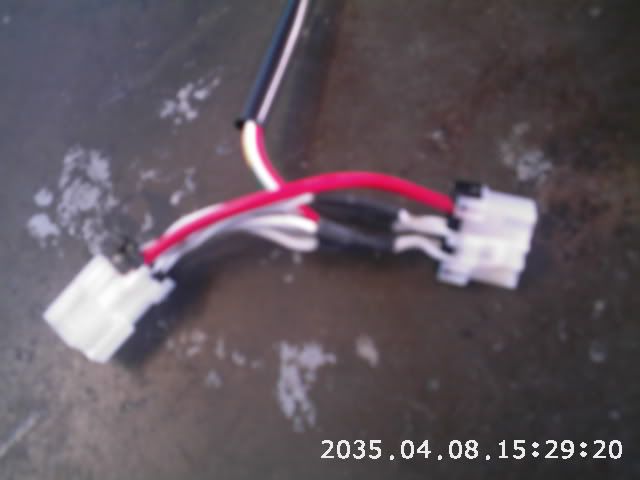

Okay, with some help, I found the problem.
The s13 TT harness, will plug into an S14 harness. In order to make it work, you need to add a wire to S13 TT harness.
I added the red one
I lent my digi cam to someone, so I'm stuck with a crapcam.

JDM cars do not have the 'hot start' wire in the ignition harness. Therefore any plug in harness will only have five wires total, not six like US cars. You have to add the additional wire like you found out.
