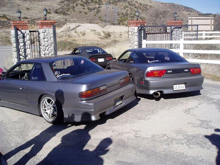

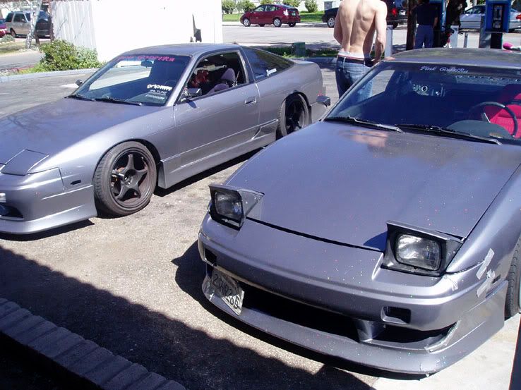

pics of my car? hmm
i only have old ones before i pulledthem w/ the hammer
but here's one
fronts are always hammer
rear was pulled
my old s13 fastback
http://img.photobucket.com/albums/v2...aytougess2.jpg
http://img.photobucket.com/albums/v2...saytougess.jpg
photobucket sucks try it later.
the othre s13 we hammered too. later rolled to pull it out about 15mm-20mm
pics big so linked.
s14
front and rear hammered
rear hammered job..pulled out to fit 18x9.5 +12
http://i2.photobucket.com/albums/y9/...g/DSC00581.jpg
http://i2.photobucket.com/albums/y9/...ew/s14rear.jpg

The first links for the S13 don't work. The S14 does though. It looks flush. How long did it take you, if you don't mind me asking.

the black s14
nice wheel setup. what are the wheel and tire specs on the front? size tires on rear?
grudge is offline   Reply With Quote
Old 06-30-2005, 10:47 AM   #17
Dousan_PG
Dousan_PG's Avatar
Join Date: May 2002
Posts: 16,640
no i wont roll your fenders
tire size
17x9 +18 235/40/17
17x10 +20 235/40/17
18x9.5 +12 235/40/17
