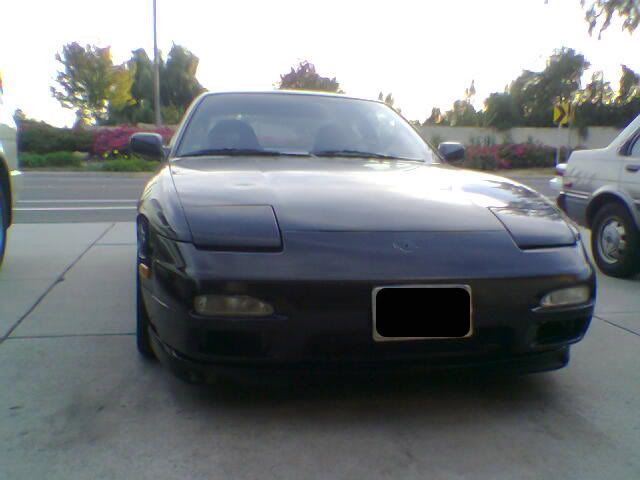

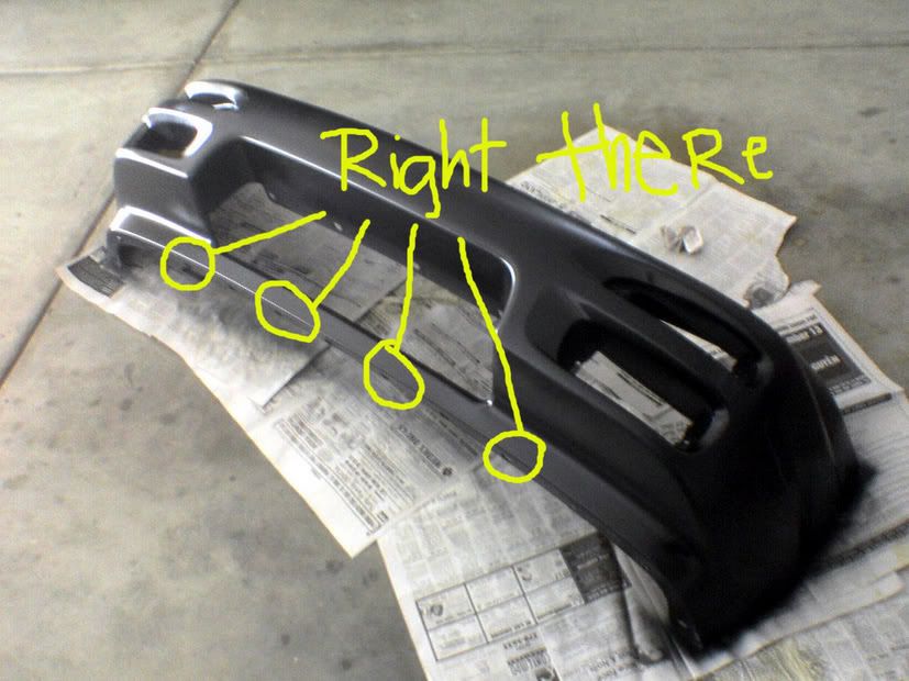

here's mine. basically, you need to remove the little lip that is already on the chuki bumper and you're pretty much set to go. There are four holes that sorta line up with the bumper on the lip and you can either dremel them to fit, or use zip ties. All four are on the front of the bumper. For the sides i just removed two of the clips that were holding in the fender skin and zip tied the side of the lip to the fender.
