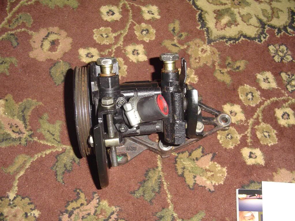

is this the DOHC non hicas ps pump?

That's a HICAS pump. Two outlets = two racks to pressurize.

thanks, I have the normal DOHC ps pump but it wouldn't mount up to the block bracket I have. So I guess the engine before was running hicas? So now I need to get the bracket
