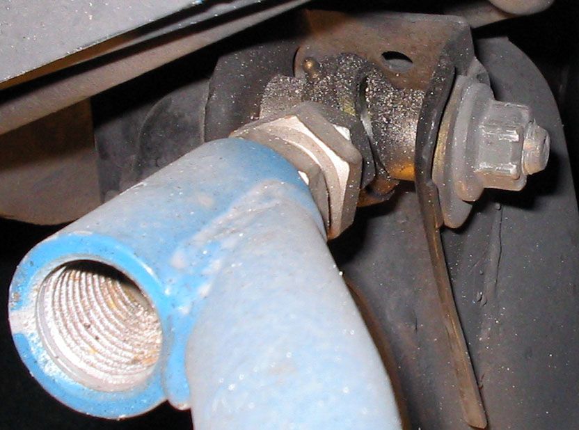

My rucas are clunking like nuts. I was told to put grease at the nipple. And that will help grease the ball joint. Thats what he did to solve his clunking problem.
I was told by an instructor for suspension class that you arent suppose to GREASE teflon ball joints. because they are self lubricating. My friend's kazama outter tie rod(end) broke cuz some dumass "helped" him grease it.
I am lost. Help?
Grease or not to grease?

You'll most likely never find the correct zerk fitting to grease those. If you do, post up.
Anyhow, those aren't teflon joints, so just spray them down with WD40 until you can afford to replace the rod ends with some real teflon ones.

1) those aren't teflon-coated. they're zerk fittings, which means you HAVE to grease those
2) zerk fittings are crap and are dangerous; they don't belong anywhere near automotive suspension parts.
you should look for replacement rod-ends that are actually teflon-coated.

well i have all the suspension parts from Ctune on my s13 right now and they did squeek a little but just grease those bad boys up and they are good to go, and as far as quality two big thumbs up

If they didn't want you to grease them up, Crap-Tune wouldn't have a zirc fitting on there.. cause those things cost money. But yes, grease them up prior to install, and like the old days when you change your oil, you'd get a "lube" job with it.

Yeah, those are crap. Mine blew out after less than year.
First they start squeaking. So you lube them.
Then squeak more often. More lube.
Start sticking. Thicker lube.
Then they bind up and blow an end cap out.

then skip steps 1-3 and proceed to step #4. do not pass go, do not collect $200
