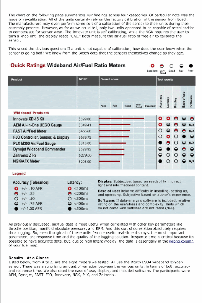

This is why I been leaning towards Innovate vs others, if im gonna use a wideband it better be as accurate and fast as possible:
Shows here PLX is off one whole 1 AFR +/-, I say thats to much.

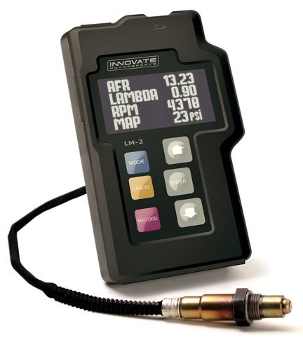

I just purhcased the new LM-2 from SPLParts because they had them the cheapest so it'll be a lil while before I get it because they aren;t in stock at the moment.

The only thing that sucks for me is im OBDI, if I were OBDII its plug and play as far as monitoring other sensors. But all is not lost they provide a analoge connector to splice in sesnors that you want to log. This brings to a questions, does anyone reading this know if its possible to make a OBDI to OBDII consult adapater? That way I can make this as painless as possible?
