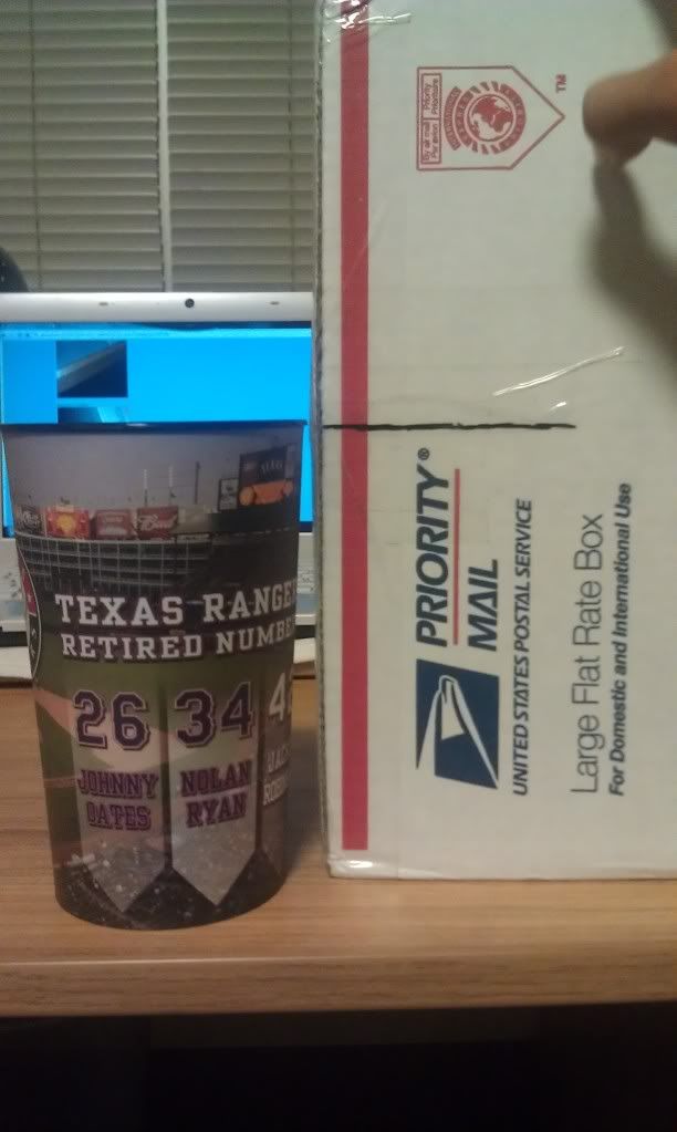

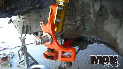

What does this picture have to do with anything? We're talking about a McPhearson strut front suspension...
And the wheels do move independently of the rest of the car, the the wheels also include the hub and knuckle, this moves your center of axis out from the wheel. So all of these childish drawings that take no consideration into the rest of the suspension are proving nothing.
What? The angle of the front coilover exactly determines the angle of the wheel. This has NOTHING to do with rear suspension.
Ok my bad I was talking about both front AND rear suspension, which is why I posted a picture of the rear suspension. If we are being front suspension specific in this thread my point still remains true though. The hub rotates around the axis of the LCA ball joint, the wheel rotates around the hub. When the wheel rotates inward it pushes the inside lower edge of the wheel down. Since the hub is connected to the knuckle and the knuckle is connected to the LCA and the LCA is connected to the front xmember and the front xmember is directly connected to the chassis, by pushing the inside-lower edge of the tire down you are moving the car up. (unless you are pushing the earth down)

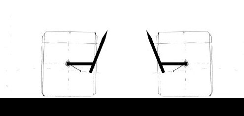

Cool hand drawing bro.
Your "diagram" clearly shows what I hand drew to scale. I only included different offsets.

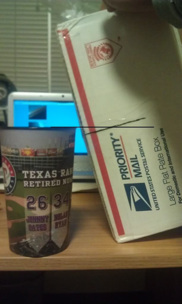

You posted a picture of a camber wheel increasing the distance from top to bottom.
And now you post this picture of this retarded car and try and say opposite? ummm....i'm confused.

Show me where you believe the ball joint would be on this diagram.

That is an inaccurate portrayal of the front suspension in an s-chassis car. The picture here is implying that the wheel connects directly to the strut. In actuality it connects to a knuckle which connects to BOTH the strut and the LCA ball joint.

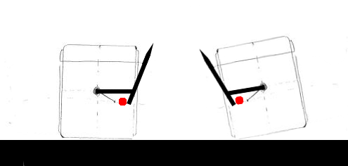

No shit sherlock, but the center line of the hub and knuckle would be parallel with the ground EXACTLY like the picture at 0* of camber.

How do you expect me to locate where the ball joint would be when you don't even have a LCA in the picture?
Why don't you look for yourself where the ball joint is. By changing the camber you aren't moving the LCA you're moving the knuckle. And by moving the wheel you're moving an edge of it either up or down, whether it is the inside edge or outside edge. the side that moves up no longer touches the ground (obviously) and the side that moves down raises the car.
Yes.
Yes.
Put these two logics together.
If the LCA does NOT move the entire assembly rotates on the lower ball join then.
If you don't agree with me on the location of the ball joint (red dot) then show me where you would like me to put it.
This is at -5 degrees. Look at the top of the suspension.
DAMN THE WHOLE CAR GOT LOWER. And the inside of the tire is at the same height.
Nice try guys.

plus if you look at the picture, it shows that it being on the edge of the tire changes nothing, yeah the out side edge of the tire is higher, but its not going to change ride height it will just tuck under the fender

Look at the wheel. The red dot you marked as the ball joint is still within the width of the wheel. and as long as its still within the wheel it means that the inside of the wheel is moving down. Also, the line you have representing the strut started out at an angle. When in actuality the strut in the car sits straight up and down at 0* camber unless you have a slotted mount, in which case it would sit straight up and down even with negative camber. This alone makes your drawing and measurements inaccurate. If you had started the drawing with the strut straight up and down the 5* wouldn't make as big of a difference in the overall highest point of the strut. And if you moved the point of the ball joint further into the wheel (like it actually is in real life), how much the lowest point of the wheel is moving down would be much more apparent.

Originally Posted by anarchyperf View Post
It lowers your car... I win
Zero Camber - pay attention to the blue line
Negative Camber
I will divulge more into this.
your picture is accurate for a negative offset wheel.
Put the blue line on the other side
Very good point.
Very good point.
The blue line doesn't even need to be on the other side of the box, just across the front.

Alright... after playing with my box for a little ... These are my findings
0 offset wheels
Negative Camber Raises car to a point. After some pretty extreme camber it begins to lower it.
Positive Offset Wheels
Negative Camber always Raises height. Until Extreme Camber
Negative Offest Wheels
Raises height until a certain point if close to 0 offset. With a wheel with a greater negative offset it always lowers the height. At what point it raisies and lowers I'm not sure but I believe it's relative to tire width.
0 offset wheels
Quoted for the truth

All that box proves is a point on that box becomes Huber or lower based on its position. What really needs attention is what happens to the suspension when that spindle/axle on the knuckle is pointed upwards; in which I think lowers the suspension. To back that up, more camber is what happens when u dump a stock car down with people in the back. The height lowers and the tire cambers. I'm not saying I'm right, but this should have been cleared up by someone by now.
