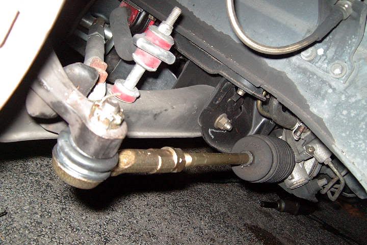

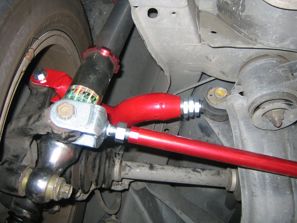

Get Ruca's so you can dial in your - camber settings, toe rods so you don't kill your tires, tie rods and ends so you can adjust front toe, tension rods for caster, and the traction rods are really a matter of personal preference. They aren't needed so much as the others but they are one of those "Well... I might as well just get em all type things.
I have all these items and a lot more suspension and it makes for a lot easier alignments as well as being able to setup your car any way you want.
Make sure and take it to a professional alignment shop that knows what they are looking at when you bring your car with all the new toys.
Here is my S14 with some of my toys:
Front:
Rear:
My suggestion to you is go on splparts.com and look in their suspension section and read literally everything. It is one of the best resources for learning what each suspension mod does.

You can take your chances with a regular alignment shop and if they suck you will know not to make the same mistake twice. If they do a good job then you save yourself a long drive. Just tell them to put the settings as close to factory specs as possible.
Toe is most important... TOE MURDERS TIRES! People think it's camber but it's the toe that does the worst damage so set toe as close to zero as possible.

I think the only NECESSARY mods would be
Tie rod ends (bumpsteer)
Camber plates for front
and RUCAs for the rear.
That's just to keep your car daily driver friendly.
