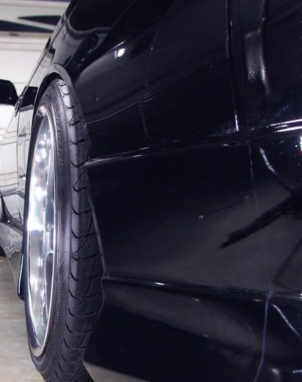

well, i know Rays still makes them, but in the US they are under a different brand.
here some pics of mine. 18's X 9 & 10 (+22)
they stick out
with the lower disc in the front, it couldnt clear my gt-r brakes or my tein he.

Here's my 57F Pros on the supra.
18x10 +32 (high disk) w/ 265/35
18x11 +21 (low disk) w/ 295/35
One-off metal widebody front fenders
Doluck rear flares
I bought these 3 years ago from Rays...took 2 months for the fronts and 6 months for the rears.

Look at my signature. I fit 17x9 +5 and 17x10 +10 on S13 with OEM fenders slightly pulled.
You now have wide fenders? Should be able to fit quite a low offset then.....S14 is easier than S13.
