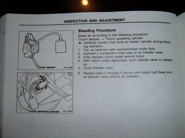

The clutch fluid is ez Simply drain it from the slave under the car. Refill fluid on top and bleed
While your down there take out the clutch dampener box and bend the pipes a little and make them go to the slave. Makes clutch a lil stiffer
Brakes is basically the same as above except replace 'press the clutch pedal several times' to 'press the brake pedal' And start from farthest away from master cylinder IE passenger rear, driver rear, passenger front, driver front

OK, thanks for the replies. Please let me get a few things straight.
So, I'm supposed to bleed the damper box AND the actual clutch "operating" cylinder? That's what it looks like from those pics. If so, that makes sense.
From what I can see, my clutch damper box looks different than the one pictured.....mine is more of a flat box. Also, my clutch fluid line goes into the bottom, not the top, as pictured.....is that OK/normal? Will it still bleed/drain fully from the top nipple?
So the "air bleeder valves" are basically the same thing as what's on the brakes, correct?
One last thing, I have heard of "gravity bleeding" the brakes, where instead of pumping the brakes you just let gravity do it's thing. I know this would take longer, but is it also an effective method?

Get rid of the damper box all together.
Pump all the fluid out of the reservoir.
wipe it out and fill with new fluid.
should only take a few pumps to fill the system with new fluid. take an hour with the damper box installed.

g6civcx, would that require taking it to a shop(professional work)? Or is the "power flush" something I can do myself at home?
*Edit* Also, I don't think I'm the lazy type, but I actually like how my clutch pedal feels and have absolutely zero problems with it. I'm a "if it ain't broke....." kinda guy, so I would kinda prefer to leave the damper box functional.
Also, if I was going to leave the damper box alone, could I just bleed the clutch cyl, or would I have to bleed the damper box also? Thanks.

you will have to bleed the damper box aswell, when i bled my clutch with the damper box it took me over 2.5 hours to do and it still wasnt good. Without it you have a better feeling clutch pedal and it takes a few mins to bleed the clutch. definatly remove it.

"It ain't broke"....yet. Once you try to bleed it, you'll realize why we're all suggesting to remove the damper. You'll spend three times as long bleeding both items and still won't get it all out, or you can remove the damper and have it bled in 2 minutes.
