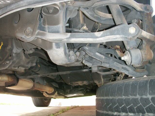

Does anyone know how to remove this damn thing. i have spent the last 3-4 days trying everything imaginable to remove it and it won't budge. I removed the two bolts from the back that attach to the subframe. Right behind the hub there is a hole where the bolt/spindle from the frame attaches to the hub. Well i got the nut that secures it off but it won't budge. So now i broke a damn hammer trying to beat it out. Does anyone know of a tool that i can use to make this crap easier to remove? Perhaps an impact hammer? I've searching the forums but i can't seem to find the info i need or perhaps i'm not using the proper key words to perform the search.

let me post pics and see if that clarifies it. but that tool in the middle seems like something that would work.

you see the part that appears just below the shock. that part won't come out. it has the little rubber boot with a ball socket. i got the entire frame free from the subframe but not from the wheel hub area.

That is the ball joint. They make a Ball Joint Fork. Do not use it unless you are changing out your ball joint. You are more likley to damage the ball joint.
Just go rent that tool kit I mentioned before. Remember to use a nut on the ball joint so when you use the tie rod remover that you don't damage it.

THAT THING with rubber is called a balljoint. If you beat on it at all, you should replace it. If it breaks, you will lose a wheel which=bad.
Use the fork separator as shown above, and then replace the joint....

ok, yeah i ended having to buy the whole part cause the lower control arm is bent. not sure if you can see it in that pick but it's shot. the ball joint is gone as well, shot it's load when the frame was bent.

ok autozone didn't have the one in the middle, they had the one in the bottom left of the pic. only problem is the drive shaft that connects to the wheel hub is in the way. so for me to use that tool i have to take everything apart. anyone live in Houston that could let me use the tool displayed in the middle. cause autozone and O'reilly's(sp?) doesn't have it.

got the tool finally and got it off, took fucking 3 turns and it poppe off. now putting everyting back together.
