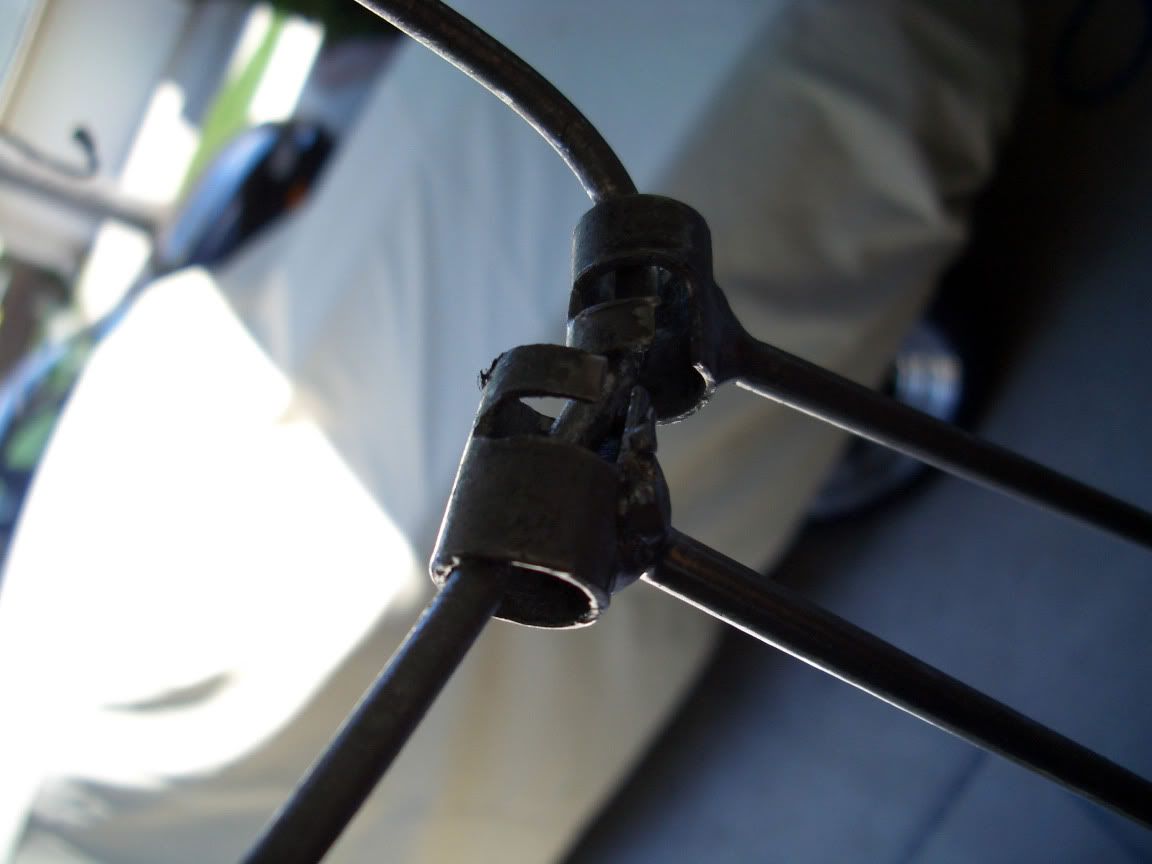

bottom line on 300zx e-brakes?
is this how most people do it? i was told that doing it this way can cause the e-brake to be engaged when the car is jacked up. can anyone confirm or deny this?

dont do it that.. way.... it doesnt work well and the cable just slips when u pull the handle..... best way is to reroute the cables the long way and use a cable clamp...those dubro collars are junk..
well, what i had in mind as far as cable clamps are not what's in that picture. i searched for a pic of them to post to see if they would be better but i couldn't find a pic. the clamps i was wanting to use are kinda the same concept of some battery terminals where i would put both cables in and tighten 2 bolts on either side of the cables. those the ones you are talking about? (sorry if that's a bad description)

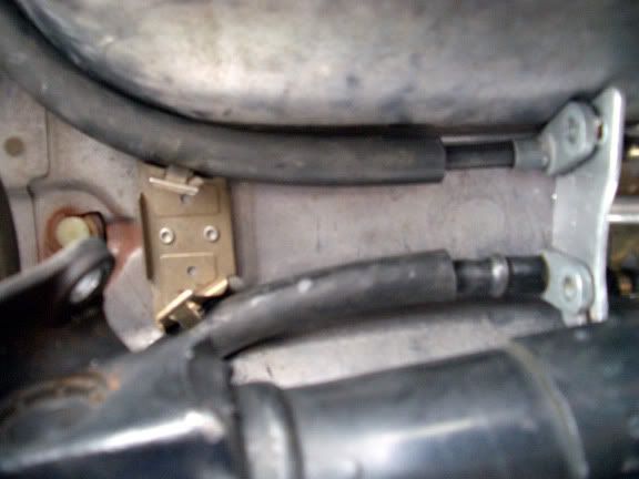

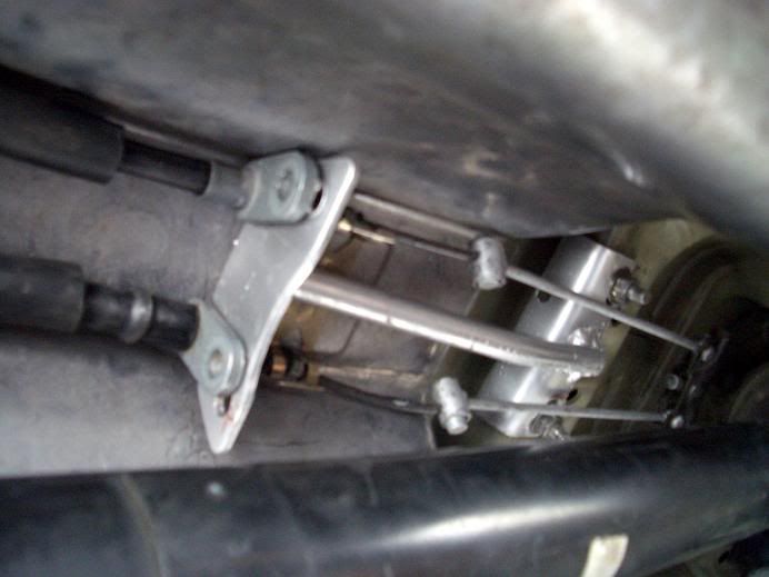

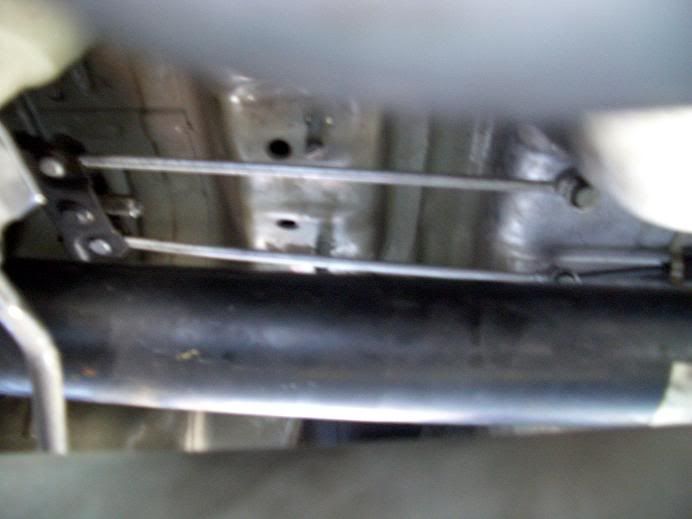

Ok I think I have the answer for the S13 guys.
This was done on a 91 240SX hatchback.
I tried both the regular Z32 cables, and the 2+2 cables.
First attempt was the standard Z32 cables, these cable DO reach. They just have to be rerouted through the subframe, some costom brackets need to be made, and the handle needs to be loosened almost all the way. This setup worked fine, and the handle felt very close to the feel of the original setup.
But I am a perfectionist and I had to try all the options untill I am satified. The 2+2 cable is next. This cable is longer than the standard z32 cable, its about the same length as the stock 240SX cable. I am still fine tuning this setup so I'm not fully complete. But this setup requires alot of adjustment at the handle. You have to take up alot, and I mean alot, of slack. I routed this cable the same as the standard z32, and made custom brackets for it as well.
Right now I have the 2+2 cables on the car, after the further fine tuning, I will make my decision on which cable to run permantely, but right now I like the regular z32 cable better.
Here are some comparsion pics, and rerouting pics:
Top to bottom: 240SX cable/ Regular 300ZX cable/ 300ZX 2+2 cable
Left to right:240SX cable/ Regular 300ZX cable/ 300ZX 2+2 cable
regular 300ZX cable top, and 300ZX 2+2 cable bottom
240SX cable top, and 300ZX 2+2 cable on bottom
Rerouting:
These are of the regular 300ZX cable....2+2 pics coming soon....
E-brake cable passed through the oval shaped hole in the subframe (how it comes on the Z32's)
Cable passed over the exhaust, and bracket used to hold it away from the driveshaft.
The next pics are of the routing, and the custom bracket I made.
Any question, let me know, I will do my best to answer them. If you need more pics, I will try to get those for you also. I'm still working on the 2+2 setup, so when I finish I will let you guys know how that goes compared to the standard Z32.
Hope this helps......

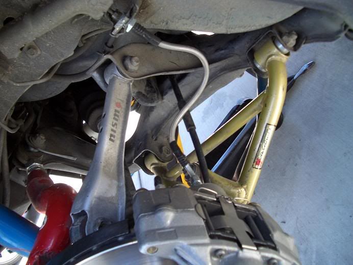

this is what i have done for my s14. i didnt make it my dad did because i dont know how to weld, but this is just a suggestion.
rest are on here
http://share.shutterfly.com/action/w...id=8DbMWzRy1fQ
