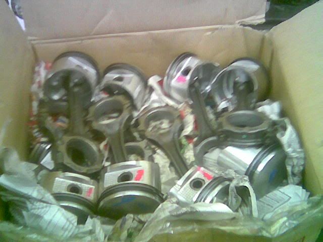

mmm high comp

Tre, that things going to yeild quite a bit when you throw those in. Whens the engine getting blue printed?

is that for a V8?????

Sweet! You must be putting a 11.5:1 SBC into your bitchin' drift YUGO!

Looks like chevy stuff

How are you fitting 8 pistons in an SR block??

WOW guys you REALLY dont know you're engines
Flat tops and i'm a KA engine guy... hmm i wonder...
3 1/2 sets of them 2 1/2 are brand new. Other set is out of an engine that put out 289hp 249tq to the crank.

You're asking us to make gross assumptions here...
What are they? What are they for? What will they do/How are they better than stock?
and, how are they better than mine?

Yours are dished and i got all of them for free
If i'm lucky i'd be putting out near 270crank hp IF i reuse the used ones. And put a decent tune down. But i'm looking more around 250crank hp
btw these ARE stock Pistons haha in a sense

GOD! Are you on this forum as well spreading your fecal matter?! Stock KA pistons wooooooohooooo

tre. Did you get these out of an offroad truck? I know alot of those nissan off road race trucks run high comp ka's.

No. Those pistons would be literally GOLD. If i got those out of the truck serious engine. IF you can even buy them they'd be around 1000+(guessing) for all 4.
I dont know if nissan has a contract with JE about that though.

Tre what you need to simplify for the forum is the difference in which a sohc piston makes higher compression.
First off all SOHC's use what is called the hemispherical head design (they have horrible flame front's, not well at producing swirl), the list can go on and on. DOHC's use a shrunken volume head design known as the pentroof which increases flame front swirl, and everything that the SOHC engines couldn't do. This means that dish hiegth is raised on all sohc pistons allowing for the higher compression in the dohc engines, but this is a big no, no using JWT cams or even PDM's for high rev applications.
Personally I do not agree with the use of the KA24e sohc pistons, the raised dish leaves no room to run high lift cams, and the oil rings are well... Not positioned to work as well as the DOHC pistons. If anything you should look more into NAPS-z 24 pistons which come flycut and would be much more suited for high rev and a high compression than normal, also allowing the use of higher lift cams.
Great so you had some stocker pistons handed to you to raise your compression.....(YAWN) It only keeps your KA limited to most of it stock settings before you bend a valve.
If anything look into something that is well worth the investmant instead of hand me downs if you plan on making a high HP NA KA.
There are so many BETTER pistons to offer like super techs, arias, CP that are designed for the dohc and will allow for better tuning as far as the valve train is concerned. Why people look for cheap power only to fuck up there engine down the road baffles me. For an affordable $450 investment any of those pistons I mentioned are much better suited.
Fuck really man if you want high compression why don't you leave the stocker DOHC pistons in and just clover leaf weld the head??? I've seen guy's make 12.1:1 CR's with head welding and stock pistons, then run massive lifting cams..... (this is the direction of my build).
So when you title a thread mmmm high comp, and all I see are sohc pistons, I'm like great this guy is where I thought it was about 6years ago....LOL

Well wernt we talking about making around a 300hp ka? Sohc pistons cant do that.
Im talking max bore, stroke, ports, etc. Lets make a 3L Ka
