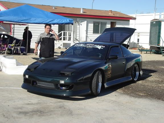

hot shit...im thinking its gonna look like this..
BN sports Aero...well they have more kits..i just thought it mite be somehting like this..

no it wont look gay like that car
that shit is ugly
type III kit and hood
stock fenders
rear will have body work done.
i hate that car. so ugly there. BLEH! looks tacky and tasteless
