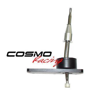

Yah, its a plastic bushing Cup.
here its at the bottom, maybe it cracked. If so, then its no a metal ball, and your shift cup so it will feel sloppy, chk this, heres a pic at the very bottom in white.
hope this helps.. I remmber this from a while ago. GL!

[QUOTE=LB.Motoring]Yah, its a plastic bushing Cup.
ya thats exactly what i was talking about. thats probably it.
