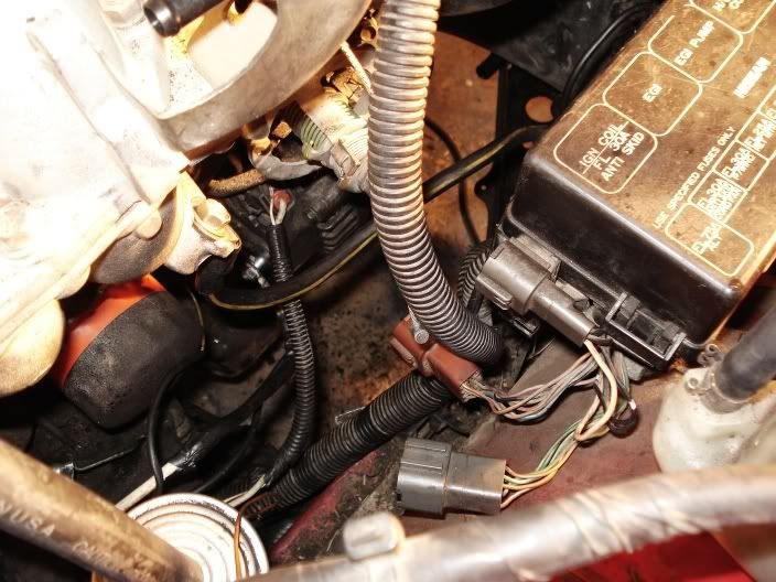

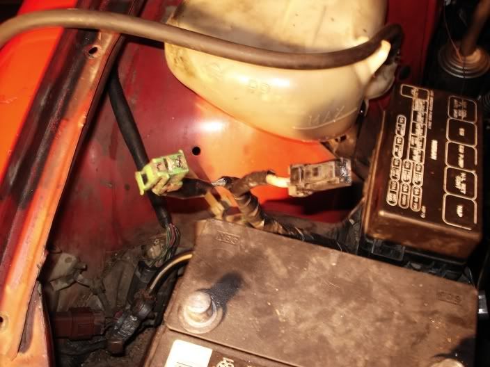

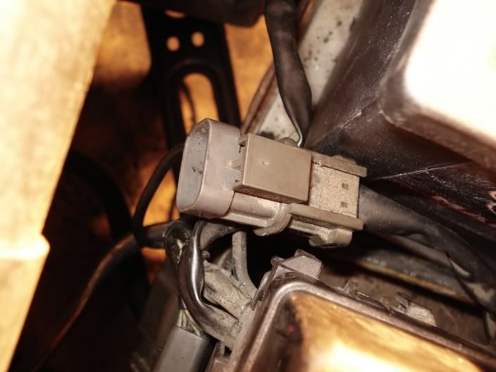

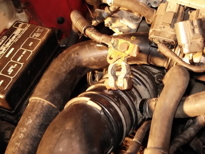

Im swapping in a dohc ka with a 5spd tranny out of a 96 into my s13 sohc automatic chassis, i've pluged up everything i could pretty much, but what do i need to jump out of the connectors or rewire to make it start, im not getting anything

I don't know for an s13 fuse box.. but it should say in the FSM.
On an s14.. the top connector on the side of the fuse box needs to have its 2 terminals shorted. (IE, stick the same wire in each and close the loop)

Are you talking about the clutch interlock relay?
It's on the passenger side.
Just jump the connections with two paperclips.
That'll get it to start.
