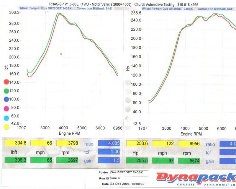

dyno results and EMS question
k i my scanner isn't working at the monet so i cant post them up but n e ways my brother payed for my tunning for x-mas woopie n e ways i was mad i got was lees than i expected lmk what u guys think .............
255 whp and 306 lbs of TQ @ 17 lbs of boost

I'm wondering why i got more Tq than hp and i was actually expecting/ hopping for at least 280whp iv seen the same setup put out 300whp or even a lil more so yeah id figure i might get 250 tq and 280-300 hp but yeah other way around any ideas why? or does 250 sound right?

Your powerband is probably pretty low in the revs, right? HP is measured as a function of torque and RPMS, and that's why you'll always see the HP and torque numbers cross at 5250* RPM - any time you're making more torque than HP you're loosing efficiency at the top end somewhere. I'd need to see the graph to know for sure, but the first things I'd check are fuel pressure and spark plugs.

Just to clear something up, it crosses at 5250.

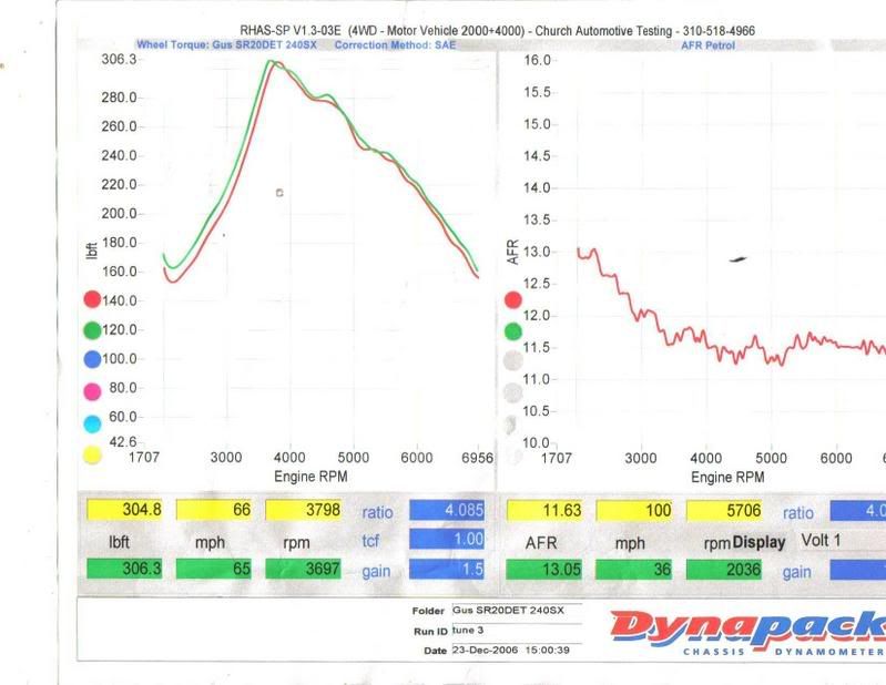

k here they are lmk what u guys think ...

I would like to see the timing map. Looks like they put no advance when boost comes on.

k i checked my fuel pressure its pretty low i believe 26 ... do u guys think that was the problem?
but im kinda thinking not cause as far as i know they car control how much fuel goes in through the aem can't they?

I think it's a timing advance issue from your Dynos.

a/f starts out lean but stabilizes at ~11.5 which is ok. Did you check the TIMING?

I agree it looks like there was no changes made to the timing map once the engine went into boost, see how quicly the tq drops off. . . Looks to be a uncomplete tune, what shop did the work?

Is the 4,085:1 diff. ratio correct? In what gear did you run on the dyno?

i know you hit me up in a PM but from what it looks like is the typical "i need cams and an intake manifold" dyno. it looks about right for where your mods are at.
if you get a greddy intake manifold and some like step 1 or 2 cams you'll probably see like another 75hp-100hp. the stock cams and intake manifold are choking you back soooo much.

With 17psi on a gt2871r .64 with no cams, you should be making around 300whp-330whp. My guess is that it's the timing or it's your motor. Have you checked the compression on your motor lately?

I Agree check the mechanical condition of the engine and if all is good you I would look at your timing map. I made 304whp on 16psi with the 3071r .64a/r stock im, stock cams with a shitty safc tune. . I would expect to see higher numbers than that, you are definetly gonna pick up some hp by putting some cams in and a greddy intake manifold also.

I also agree im pushing 280whp @ 11psi with a 20G (top mount), 750cc injectors, stock everething with a SAFC

Post up your timing map. Until we see it its all guesses. ALL of your power in a tune is in the timing.

Standard way is to wire the clutch switch as an input and use that to turn the 2step on and off. Looks like you have a S13->S14 hybrid. I won't even try to figure out the pinout. Look in the aplication notes for your ems model.
To get the map. Open up the timing map(table veiw) and Hit 'Print Screen' then go into Paint or Photoshop and hit paste in a new window and save the image.
Do you have the latest firmware and AEMTuner?

i put down 253whp and 250tq with the stock t28 stock injectors stock ecu. you should be making way more.

thing is my speed sensor isnt working so i can boost while im at a stop like a 2 step but since it doesnt read mph i put it to set off at 2 mph but obiously it never reads 2 pmh so it it dossent diss activate .. so it wont let me go past the rev cut/ fuel cut
