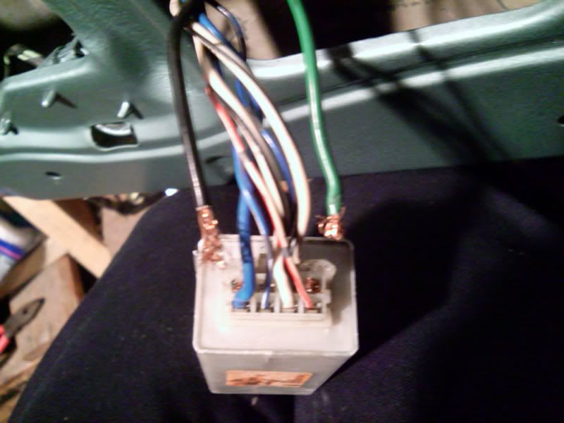

hello hello. need a favor from anyone with power windows willing to pull their door panel off (driver's side) real quick to snap a picture of the... well.. dont know what its called... but its like the actuator to tell the window motor to go up and down...
wen u press the button to go up or down, this like black box clicks (its actually a little white box, but wrapped in a soft black material). anyways, the black and green wires were cut. just wanted to know which one goes to which slot. see pics to understand better...
problem: basically the pass. side window works, but the driver's side doesnt... figured. to be honest, i tried connecting both wires to each corner, didnt work. so i switched sides... still didnt work.. so i figured a picture from someone would be much easier.

What car do you have? Try looking in an FSM; that should tell you the wire colors.

sounds like on top of the wires being cut, the actual actuator is fried. just connect it back to where the passenger window works.. the replace that box.. if you need a picture and no one puts one up btt i get off work, ill throw one up.
