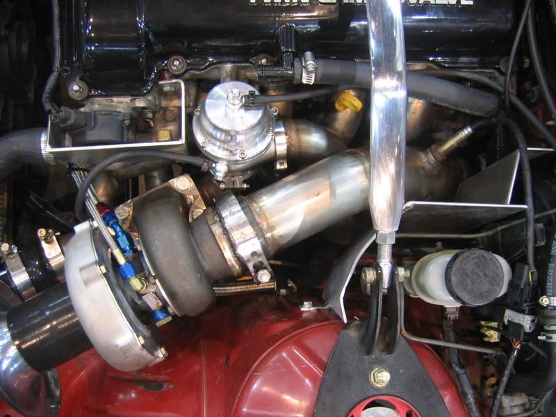

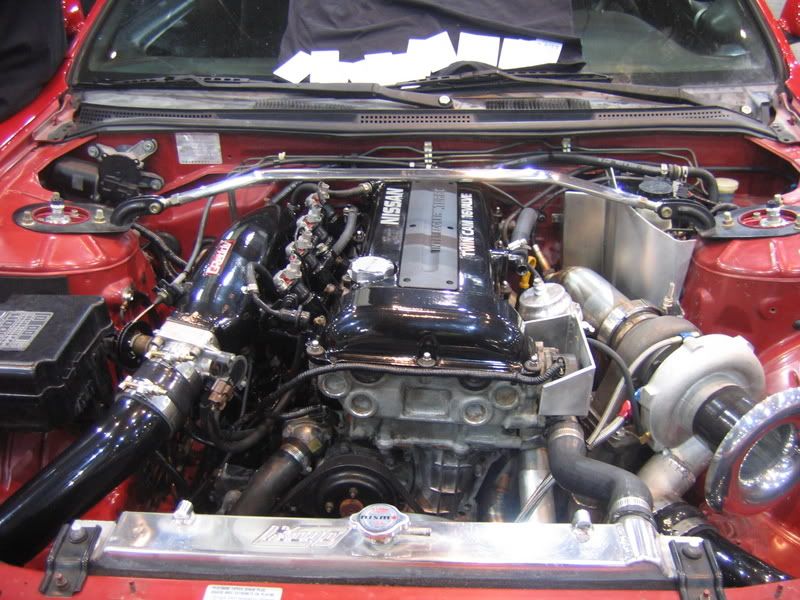

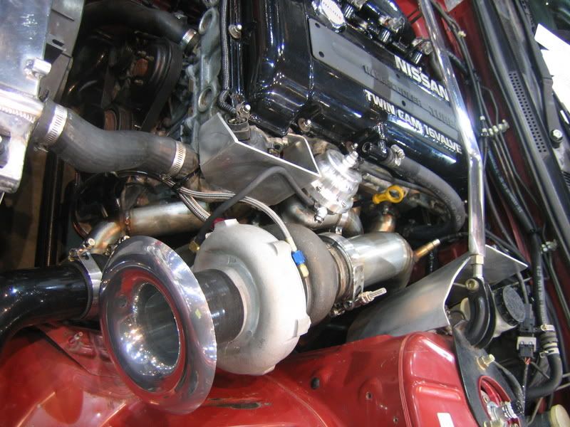

435rwhp@19psi GT3071R .63
The car is finally tuned. 366whp@13psi and 435whp@19psi. The car has more in it I think because he stopped the pull around 6800rpms because the alternator was messing up and we never did another power pull. Heres a quick mod list:
S13 SR20DET
GT3071R .63
Custom Top mount manifold
GReddy intake manifold
GM 3 bar map sensor
AEM EMS
AEM Wideband
Brian Crower 264s
Dyno graph coming soon

When did you make full boost in the 19psi run?

if you only went to 6800rpms, ofcourse you have more power. Where is the proof/detail though?

what about internals? stock?

Not sure it looks like before 4k, they have a feature on the dyno that tells me when i hit it Ill have to go down there and check.

yup all stock bottom end. ARP headstuds, apexi hg

do you think there would be much change from top mount to bottom in terms of power other than i'm using a gt3071r with a .86 arwith a 90trim turbine and t25 housing

its poop
go top mount and external for consitancy and ease of tuning + heat.

I wanted to stop the psi at 19 because scott enthalpy recommends that to be the highest boost to use on the street to be safe and avoid detonation. Now my buddies run 22-23 psi on pump gas with no problems but scott is scott so ill trust his opinion.

I have the 264s. I also have the springs and retainers waiting to be installed. I chose the 264s because I wanted response which they do but they also have a nasty topend. Probably alot to do with the GReddy intake manifold.

the t25 housing is going to be holding you back alot. Id say go top mount with a t3 backside.

Your right 264s, apexi hg, arp studs, ras, but i have full brian crower top end ready to be installed in the next couple of weeks. Im sure ill lay a few ws6s and vette down at the track. I have a cusco 1.5 and drag radials coming soon but i need subframe conectors and spacrs to get rid of the wheel hop. Alot of my buddies have TAs and vettes so its funny you say that. My buddy is making 412rwhp in his kat s13 and he was dead even with an 06 z06 from a 2nd gear roll all the way up to 120ish.
