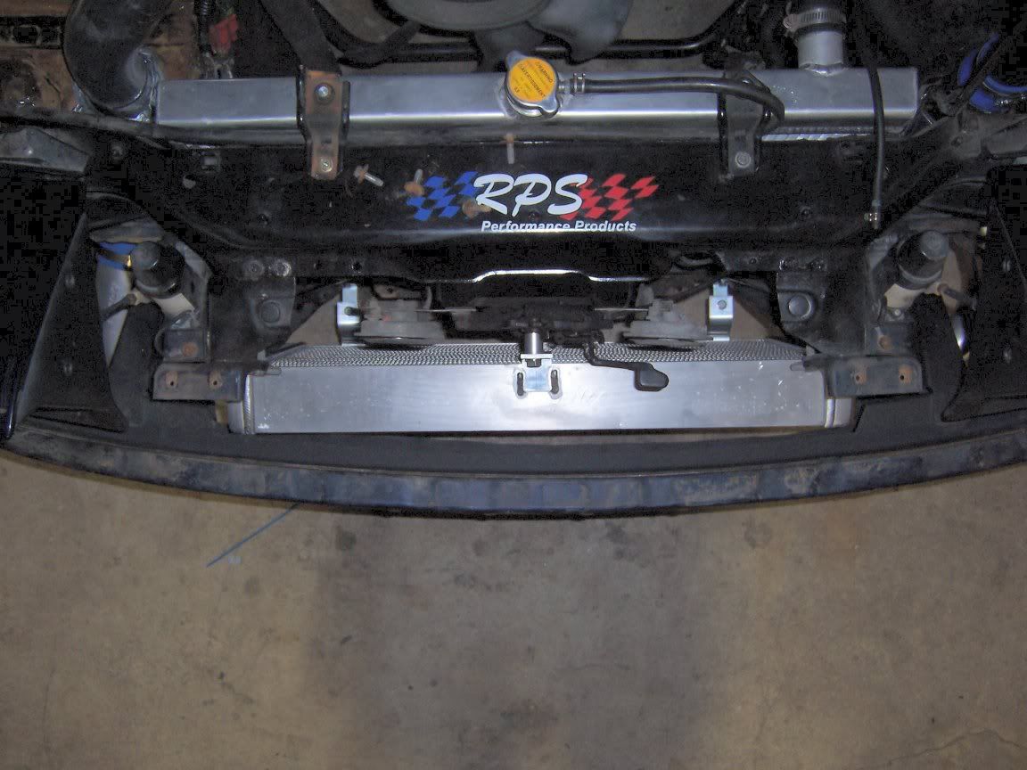

Originally Posted by s13envy
I was able to trim my bumper reinforcement to fit over my Greddy VSPL kit.
maybe that will help you some. Also some of the kits lean forward more like my Greddy kit. You can do what I did and redrill the top bracket and rotate the the fmic in some to gain more clearence.

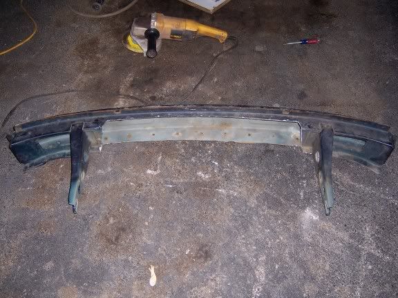

i trimmed it a bit(black) and rewelded it(red)
hell it's probably stronger now than it was before. Before it was folded over and spot welded in maybe 5 spots? Now there is a bead all the way across.
I had no problem fitting a 3 inch thick core with plenty of clearance
