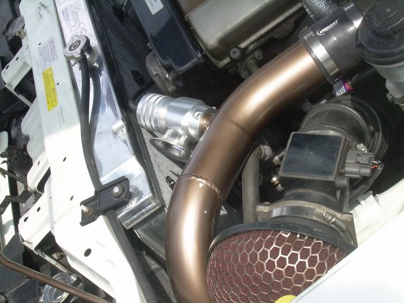

well i do feel alot of hot air comming out of the engine bay
ill post pics up
thanks

ok so its heat soke thats causing everythign to over heat.
im runnin two ten inch pusher fans
is ther anythign else i can do to get rid fo the heat /????
pics
