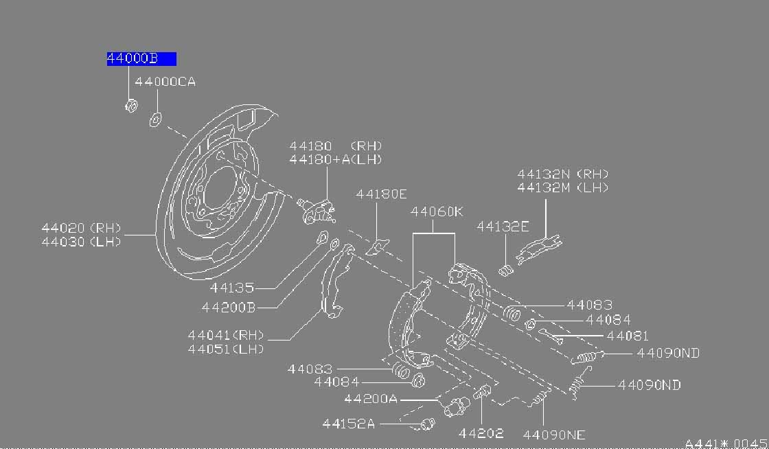

what size is the rear nut for the z32 backing plate?
so i went to nissan and they are back order so they would have to get from japan. i had bad experience w/ that already so i dont want to order from nissan and wait too long.
its the big dirty nut that goes in the back my kit didn't come w/ one. just want to know the size and thread pitch or where to get one asap.
its part# 44000b (highlighted in blue)

Its a M18x1.5 or M18x1.25 I don't remember for sure tho. I just took my whole brake assembly to a bolt and nut store

27mm socket removes it, and IIRC it is the M18x1.25 as mentioned above.

thanks guys!! im pretty sure that is the size too since i know a 27mm socket goes there.
