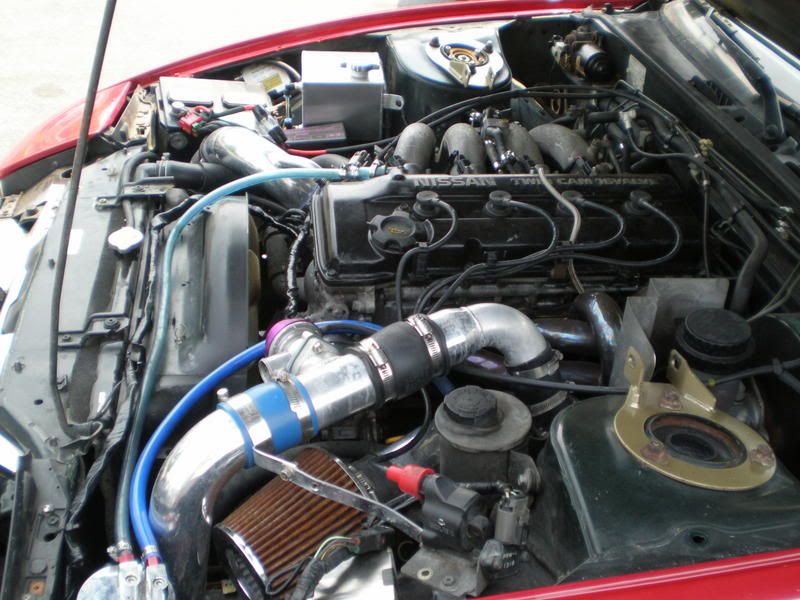

Currently im using an n60 mafs with 370 injectors in a blow through setup. i think i still have some vaccum leak issues to figure out becuase currently the car runs a bit rough. I saw someone said that they switched ack to the stock mafs and their car ran a lot smoother. i am only running on about 7 lbs so would the stock mafs work fine for that? Also i have been thinking about switching the setup to a pull thru and put the mafs on the end of the intake. What benefits would i get from doing this? Also when the car is sitting at idle on its own it backfires extremely loud and shoots a flame out of the exhaust, what would be causing it to do this? I also changed the plugs today with bkr5e ngk's
92 Hatch, KA-T, T28, 12 PSI, FMIC, 3" TBE, EFI ECU, 440cc Inj, And more...

flamage comes from running too rich

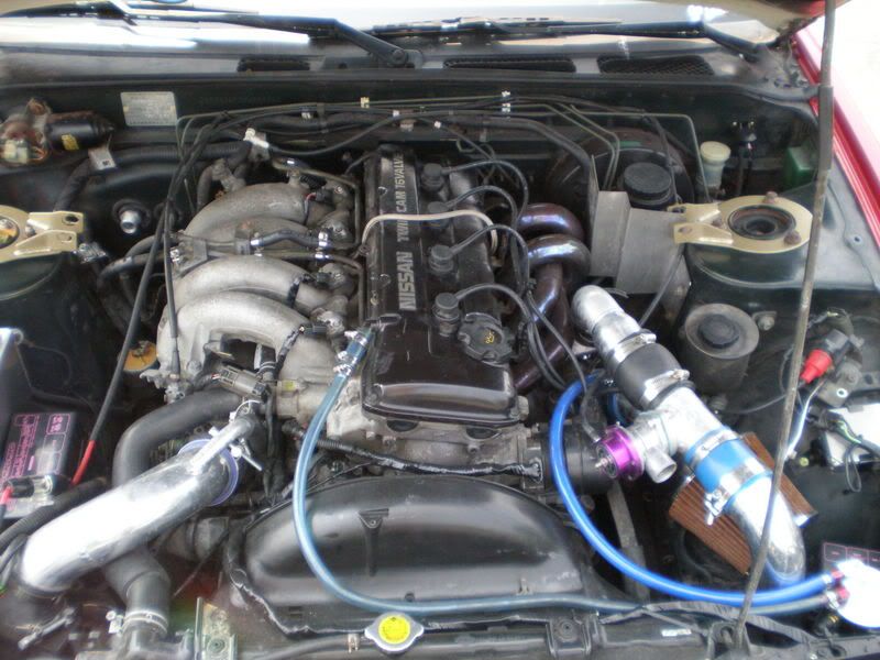

Bad idle/running could be alot of things - I see you have a open atmosphere BOV - those are known to case problems like that - not sure if thats the issue - but worth a look.
Also I dont see your MAFS - that could be another reason for the problems - maybe its not located in a good spot?
also loose those crappy clamps and get some T-Clamps - you could also have leaks in your plumbing!

I think your maf is to far away on the cold side. Move it up more that should fix the rich conditon that your having

well see the car use to run complelty fine except it would not idle on its on. But when i put the new hot pipe on it it started running a little weird and then i the 440cc injectors i had mad it run like poo, so i just put the 370cc's back in but it still doesnt run that great. So the extremely loud (pop) back fire it does is becuase its running too rich?

OE MAF is good to 8psi, but you're right on the edge. Keep the N60 and retune it.

what should i retune it with? my safc or are you talking about a rom tune, im thinking about just spending the money and swapping in an sr

is your AFC set for the maf you have? You can make a boost leak tester for like $3 using pvc fittings. They work awsome. any leaks well be a wistle.
stock KA mafs are good to 250ish HP

My safc is set to 3in 5out for my maf and i beleive those are the right in/outs for that mafs

dude get new plugs. I dont know why you are running such a hot plug. Get something in the 7 range. With NGK the lower number you go the hotter.
Backfire, especially with flames means the car is running way rich. How are you tuning the car? Are you taking the car to a dyno or do you have a wideband o2? It doesnt seem like it since you said you just "threw in" some 440cc injectors.

Hey jds performance FYI i did do enough research, how would you know how much research i did or did not do. You are not exaclty helping this thread go in the right direction either, so in that case how bout you just stay out of it. Im only thinking about dropping in the sr becasue my dad said he will split the price with me if i decide to do that. Also i wanted to go sr before i even started building the ka-t. And why not drop in a motor that has 100,000 less miles then the motor thats in my car. Honeslty how bout you just stfu. Its people like you that bring the fucking site down. All i did was ask a few questions to help me out, and the other people on here have been kind enough to help me without trashing on me or the thread.

Standard questions.. Have you reset your ign timing? Have you pulled the codes (what are they if any)?
Jegs sells a really cheap 3/8" tee fitting with a 1/8" NPT port for adding a small fuel pressure gauge (they sell that too). I'd pick up a Nismo fpr, they are fairly cheap, reliable and re-saleable. Your fuel pressure should be 43.5psi (aka 3 bar) at idle with the vac line unhooked.
All these posts talking about going back to pull thru setup to eliminate problems with the BOV are misguided. I'd leave it blow through if at all possible just for that reason (providing the MAF isn't maxxed out)... But you might want to change over to pull thru for testing purposes to see if it solves your rough idle. I think I see your MAF on the left there on the coldpipe elbow? Supposedly you're supposed to have a 6"+ straight section before and after the MAF so the airflow is accurately measured. Turns and elbows in the pipe can cause turbulence and a poor reading = poor performance.
As mentioned above, build your own pressure tester. Basically a PCV cap of some sort with a tire nipple sealed into the end. If you search my posts I have a few posts with some links to home built boost leak testers.

N1smor- If he was trying to help me then he could have only mentioned the dvd he made, and left out all the other stuff he said. Everything he said minus about the dvd was in no way helping me out.
There is no way that i can have a 6" straight peice of pipe after the mafs because there is a bend right as it goes into the throttle body. The car ran fine before with the mafs at that location so i dont think that is a problem. I just want the car to go back to the way it use to ran. No i have not reset the timing. Iv read that i should retard the timing about 2-3 degress from stock.
