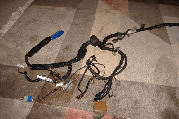

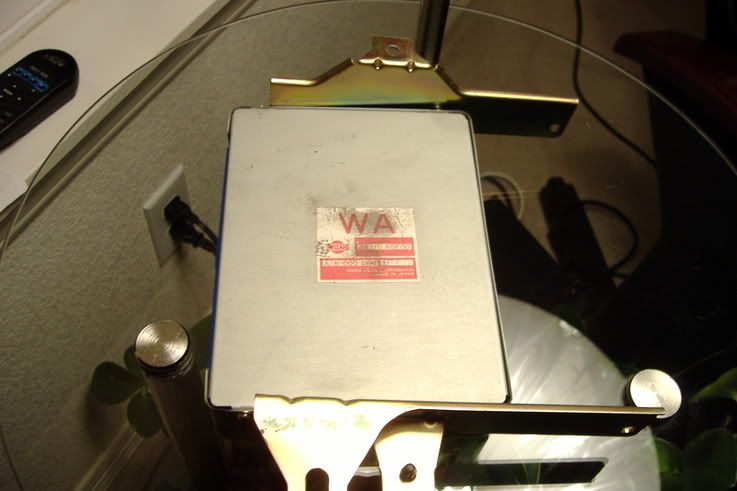

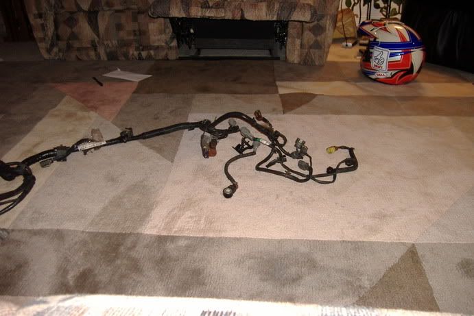

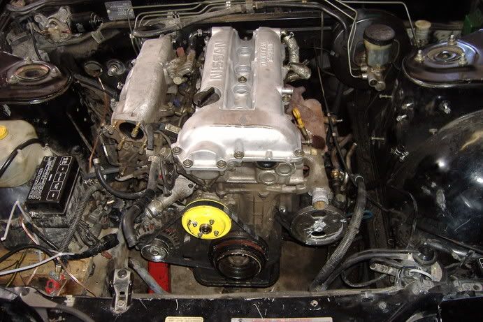

i had this swap in my 89.
find a dual cam harness an cut and splice it like a ka24e-]ka24de swap and that all it needs to run harness wize. buy to get the vvt working send out the harness to some one. i suggest doing this b/c a ka24de felt like it have a lil more mojo to it.
the ecu you need
the srde harness
kiss my bumper is offline   Reply With Quote
