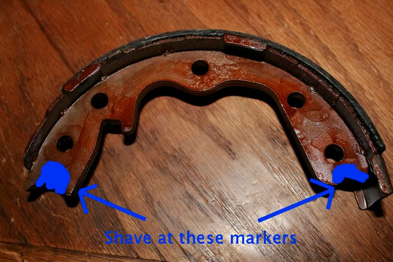

When searching around I couldn't find the MU or Endless. I found the MU shoes on SPL's site this morning. Couldnt find the Endless on Aspec site, maybe logan can come in and drop a link for everyone.
I sent lindsay (flyber) a P/M so he could try a set, aaron and him can do side by side comparisons.
There was two different ways for these to be built, the first was to set the pad thickness to OEM and use a DuPont Cement, which is what is pictured above. The pad is shaped and set to the shoe, then baked in a high temp oven to cure it.
The second way to build them was to rivet them on, but doing so you would effectively lose half of the pad thickness before it got down to the rivets. The most effective solution for someone willing to invest some time fitting these would be to increase the pad thickness well over OEM spec to 5/16th's and rivet the pad onto the shoe.
The guides in the shoe would need to be ground down to sit the shoe lower against the drum.
like so:
This is an old historic cup car trick, oversizing the pads, and grinding the shoes down to fit more into the drum.
The price on these is less than the MU's but requires a core exchange because they are not a full production item by any means.
