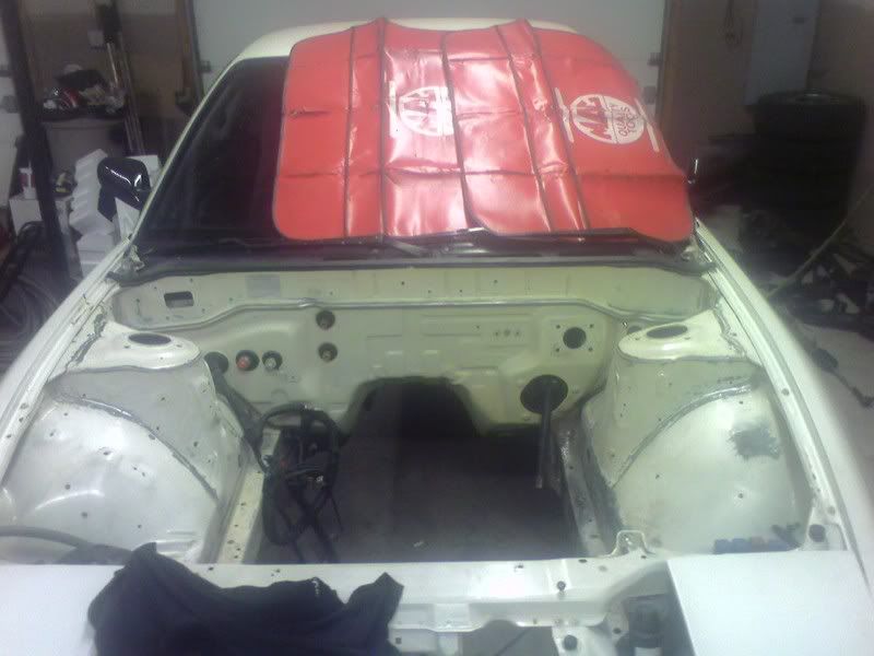

Mods:

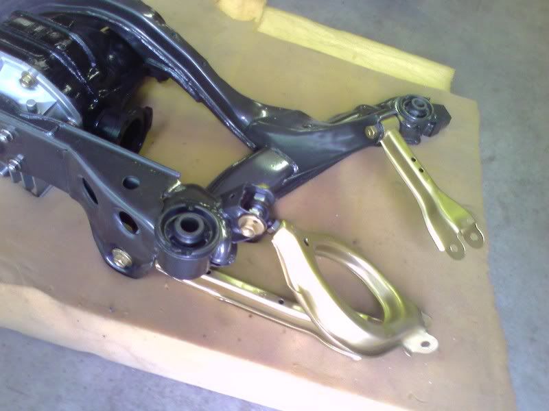

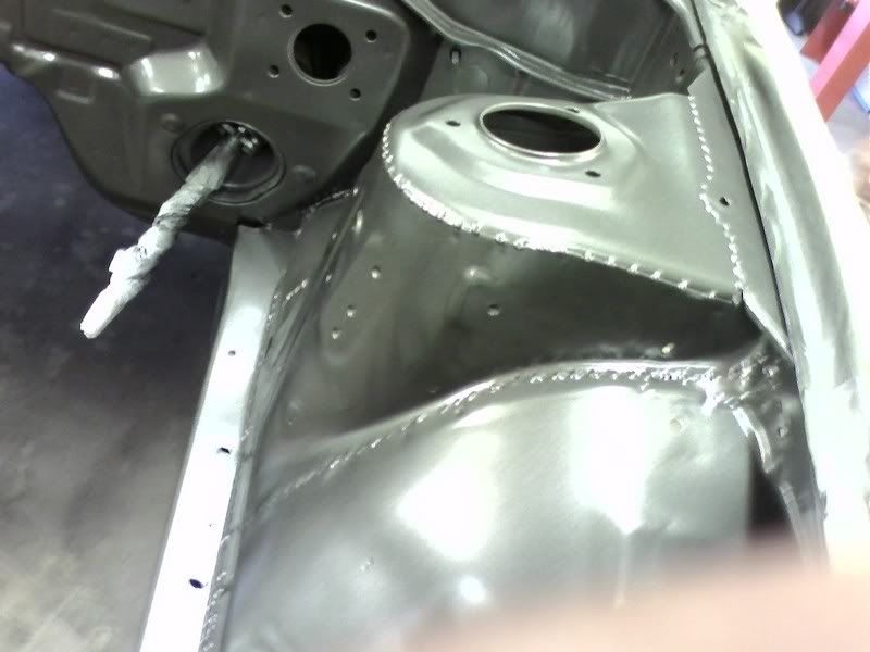

Stich welded strut towers
Homemade Power Brace

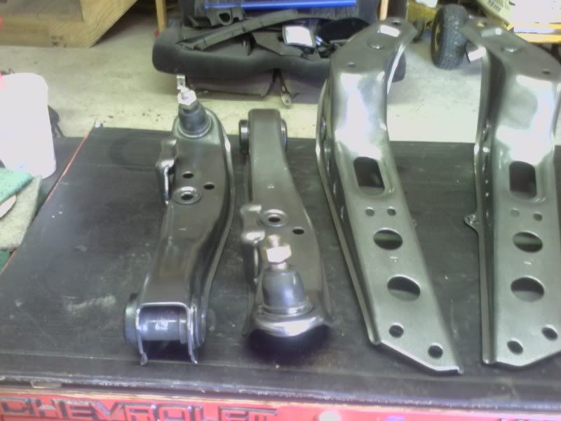

Homemade Rucas
Homemade Toe Arms
Boxed in everyother suspension arm

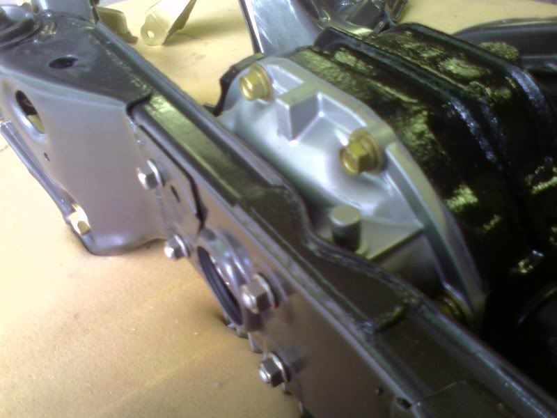

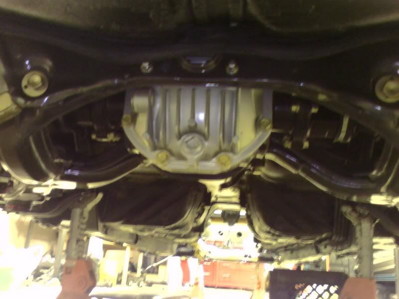

Bead Blasted and Painted everything!!
KA24DE swap:
Bored .020" over
Block Decked to minimum
Head shaved to minimum
Crank was fine so it was alright with a polish.
248/248 cam swap
Port and Polish done by myself
Egr removal
Header
Oem Exedy Clutch
Cometic Head Gasket
Oil Filter Relocation
Cleaning work:

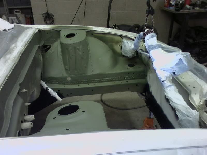

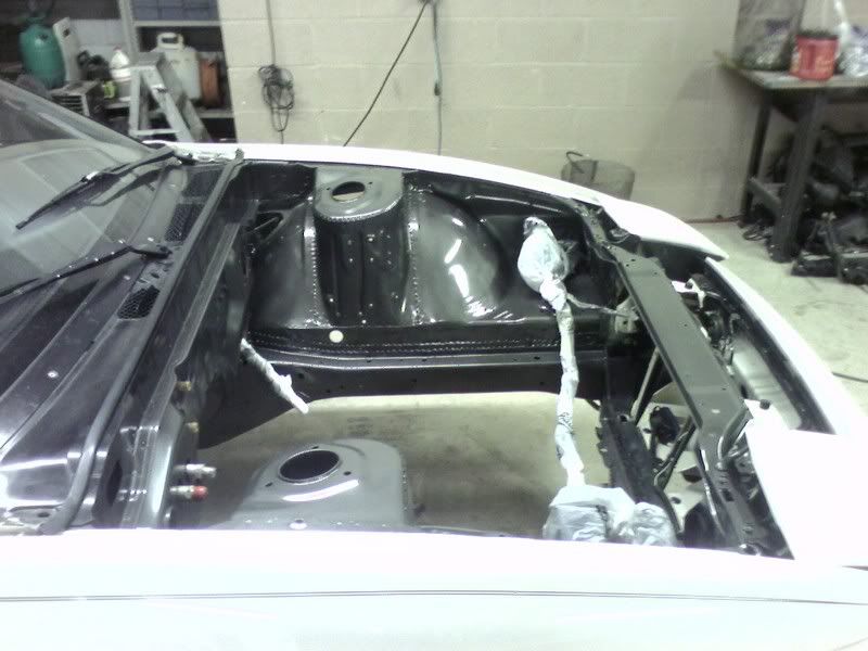

Everything in the engine bay and under the car has been stripped down rebuilt and painted. (including every bolt)
There has been more work done to the car than the pictures show. My bro took his camera with him when he left, so i have no camera.
I hope yall like it. I'm sure somebody on here is going to find something to complain about, but owell i like the car. its mine, its not urs, i dont really care what you think about it.

looks awesome. Man you spent a lot of time in that engine bay.

super clean dude not sure about the gold but hey its your car, but man you can eat off that thing

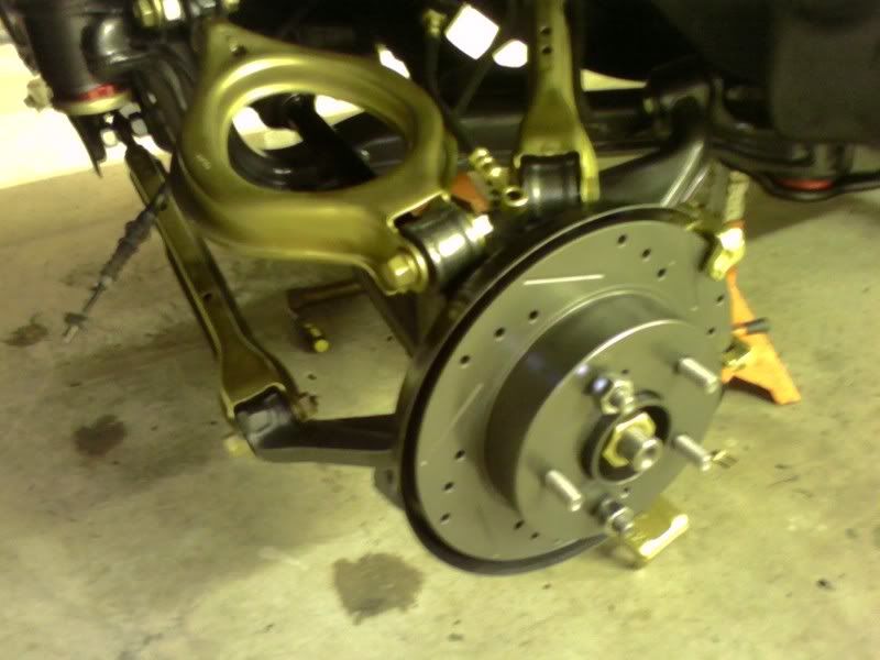

sbanzer123 is a jewel in the roughsbanzer123 is a jewel in the roughsbanzer123 is a jewel in the roughsbanzer123 is a jewel in the roughsbanzer123 is a jewel in the roughsbanzer123 is a jewel in the roughsbanzer123 is a jewel in the roughsbanzer123 is a jewel in the rough
is it me or does the guys arms in the 5th pic look way to hairy to be a 16 year old?

Send a message via AIM to blu808
Nice work. Very original on the control arms. I just home those joints are rated for that load level.

Send a message via AIM to 90KAcoupe
^^ yea they are. i dont know the weight rating off hand but that was onething i took into consideration when i picked the size i needed. these are mainly used for custom drag suspensions and rock crawlers. so i think they can handle a little 240.

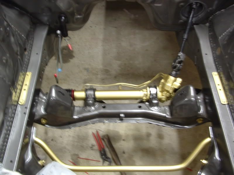

Feedback Score: 106 reviews
Nice stitch welding! It's a bitch huh? I stitch welded my entire front end and I fuckin hated every minute of the prep work, the welding itself was not that bad though. Serious props for the custom work man most of the experienced 240 enthusiasts piss their pants at the thought of all that welding. You should re-route the chasis harness over the strut tower instead of leaving it in the fenderwell though. It's not that hard you just have to be careful not to break the clips that hold it down. Also you have to completely dissassemble both fuseboxes so be sure to mark the position of everything if u do it.
