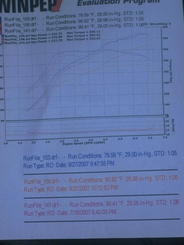

I made 330hp on a dyno dynamics
S13 sr stock bottom end, fresh head (new everything)
gt28rs @ 15psi
hks step 1 264
freddy intake mani
tomei expreme
enthalpy tune
greddy pulleys
Unorthodox crank pulley
spec flywheel
1 piece aluminum driveshaft
Couldnt hold 18psi to redline, boost kept dropping off, but you can see it made about 20 more tq and the power came on a bit faster in the midrange.

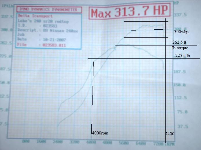

If you guys are in Cali have a power fc or want a haltech, I can tune your shit like this all day sideways
here is lukes car we just did with a straigth
50 trim/t4
264 cams stock bottom end,
PB mani,
Haltech E8 Plug and Play
STOCK intake manifold and TB
38mm wg
PWR FMIC
91 octane piss
12 psi of boost
Like Me on FaceBook !

Location: Austin, Tx
Posts: 2,168
Torque is dropping like a stone.
and I geuss it doesn't like boosting 18 because it looks like its dropping back to 15.
That turbo looks not too great

The turbo is awesome if you dont want over ~340hp and ridiculous spool up. It holds 18psi fine with a proper wg/controller.
