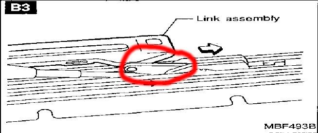

After looking through the FSM I found the piece that is broken. Here is a pic... Do I still have to get the whole slider assembly just to replace it?

that latch can't be sold seperatly, i tryed. that latch is part of the slider assembly, so you would have to buy the whole assemby.
i know, i sucks.

http://www.trademotion.com/partlocat...=4&catalogid=2
heres a better pic. 900$ damn!
