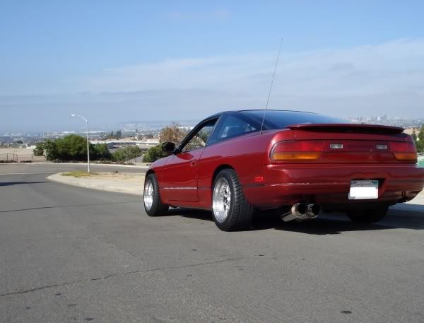

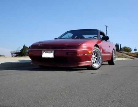

Pics of current ride heighth? I know it looks sick to slam your car, but resist the temptation. It fucks up the suspension geometry and causes more body roll.

That's pretty much where mine is at right now, but I have Apexi coilovers (N1 ExV). They are relatively stiff and I still rub my front fender liners/rear fender with my tires during spirited driving. And that's with Whiteline sway bars. This is just to give you an idea of how much suspension travel I have. During normal driving, I could probably get away with an inch of travel (compression).
Are you a spirited driver? Do you do canyon runs? If so, you'll need more than an inch of travel. Hitting bump stops in a turn an be hazardous. It'll upset the balance of your car and possibly causing you to crash. If you remove the bump stops and bottom out your damper, it'll eventually fail.
serturbo is offline   Reply With Quote

Judging by those pics I'd say your ride heighth is ok where it is. Maybe a LITTLE BIT lower. Bottom line is you need bigger wheels and better coils to make it look right. My ride heighth is about in the same spot, maybe just a bit lower, but I'm running tein flex which have full length adjustment. Honestly I don't blame you for wanting to go lower, but bigger wheels will make it look MUCH better.

yeah i figured if i went 17s.. id be more lowered than i already look. I already scrape the frame going out of some driveways, some of my friends with dumped s14s on 17s say they dont even do that.

are the tires stock diameter?
