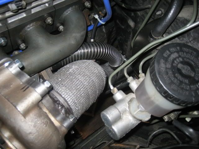

wondering has anyone used one of em. i came into a space issue that I dont real comfortable w/. nor do I feel its safe to shim the master cyl, causing the drivers side of the motor and then placing a heat shield in. honestly i drive to aggressive to even entertain that thought.
~skott
t304e down pipe flange and master a lil too cozy.

Is it custom welded?
The pre-welded ones give PLENTY of space.

Posts: 2,741
^^^werd
if you weld your own, your supposed to put the flange pretty far forward like they have in their pre-made manifolds.
post #666

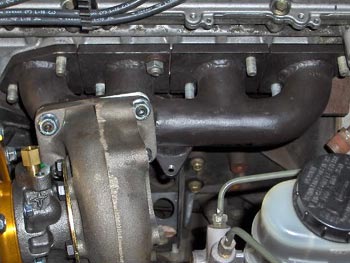

This is a picture of a pre-built manifold, which has plenty of clearance to the master cylinder from the turbine housing.

Is you car automatic, or does it have ABS? If so, it will have a thicker-than-the-5-speed-version brake booster.
If not, and it's just a normal 5-speed car..then you have a manifold that someone welded with placement for a smaller turbine, or an on-center housing (is it a T4 turbine?).

sorry everyone. i fail sometimes at making myself clear. the manifold i has was something like an ss auto chrome. hence why i was having the space issue.
my Q was in concern w. the JGS manifolds. i was wondering was there any cons to the JGS manifold. when the prior owner "ballinmiami" had this setup. he made 311 whp and 278 tq. in 9 psi. think that this will still allow me to get the same numbers? inquiring before i buy it.

That is largely going to be dictated by the size of the turbo, intercooler, intake manifold, amount of timing run. There really are quite a few factors that come into play. It's not just...if I run this manifold...can I make XXX power.

the JGS mani has less flow than your tubular mani, but miles more clearance.
not to mention, if thats an ssac then you have to worry about it crackin way faster than the JGS.

and skott, I think a heatshield is always a good way to go, or heatwrap the M/C.

Those DP welds look like shit. lol

Originally Posted by NI_YON_Zenki View Post
wowzers, russellpants. 56 reps huh?
rough it out A?
I thinks JGS has the best overall option for KA-T development in the gray market yet. and here's why. .. .all IMO.
any preset prebuilt manifolds or log types are very well off in the KA-T lineup, for price and durability for H.O. turbo KA's. ( or those wanting to get there?) But these types are typically displayed by/for disco potatoes (T3/T04E) so when looking at the marginal value, we see JGS up top, based truly on time and efficiency under installation, heat durability, and service convenience.
was thinking about wrapping the DP and the MC. IMO shoukdnt have the shield it after all that. you know
JGS FTW.
cant agree more. tho I cant say much i dont weld nor do u know who welded it. jus cant wait till i can get er on the road again.
