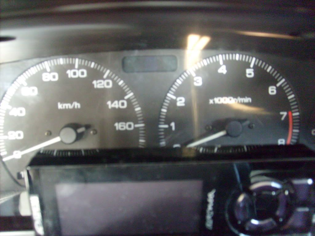

Ok so as some of you may know i was having (as well as others) a dash light brake light issue....i was told to check my harness all the way to my fuses....both were fine of course as i had checked them before posting.....however with the recent posts of the same issue i decided to go back to basics and check the switch itself here is what i found:
here are the dash lights with switch turned to on position (parking/daytime) as you can see no life in the dash at all :anger

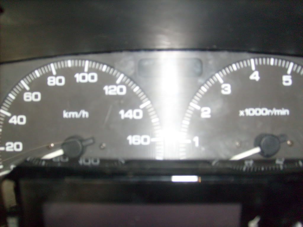

however even though headlights are on and working nothing from the brake lights (note:they work when depressed/pedal is down)
dash still up to its old tricks and nothing has changed :badboy

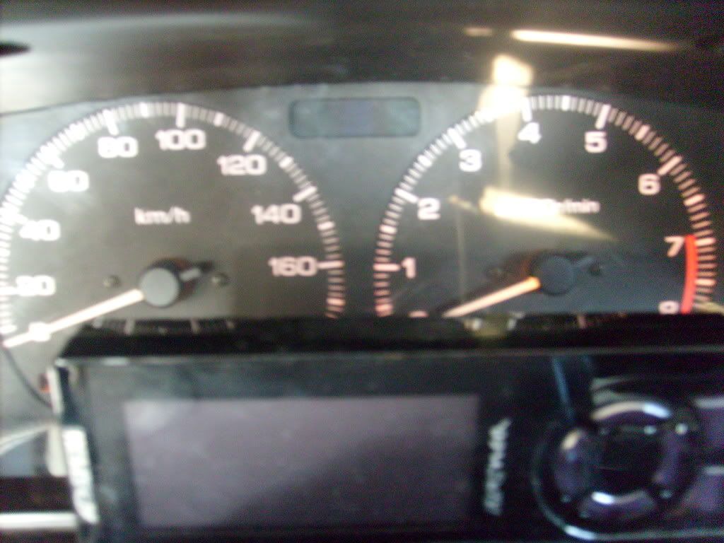

lo an behold if you give em the business (press it down) it makes connection and on the 240th day you have light again :bowdown
hey look who decided to join the party

and there you have it folks this is what i found to be my solution hope it helps
o yea u might wanna know how to fix it too huh lol....well i used some needle noses and bent it SLIGHTLY (too much and you will either break it im sure or your lights will never turn off due to constant connection)
Sticky??????
also please post if this helped you thanks and GL

And although you made a lot of effort, I don't see any changes in any of the pics except a blur and a flash in each one.
