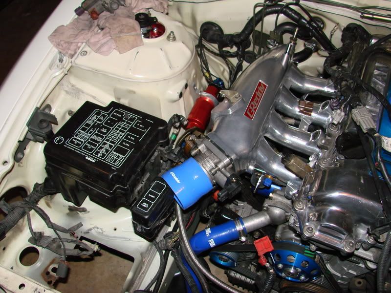

Thinking about buying the new Greddy S14/S15 Intake Manifold?
Just know that you're going to have to re-locate your fuse box.
I had to unbolt mine and push is aside a little bit just to mount up the throttle body. Had to remove it completely to fit on the cold pipe.
I blame my Gizzmo intake manifold gasket. That extra 5mm screwed me!
