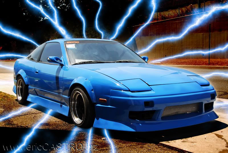

my car on RSR, 15" rims on 50. fender flares help a little though.

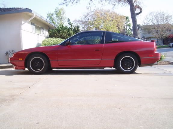

im running KYB AGX with Eibach Pro Kits and 15" wheels...not bad, handles well in the corners but not much of a drop.
