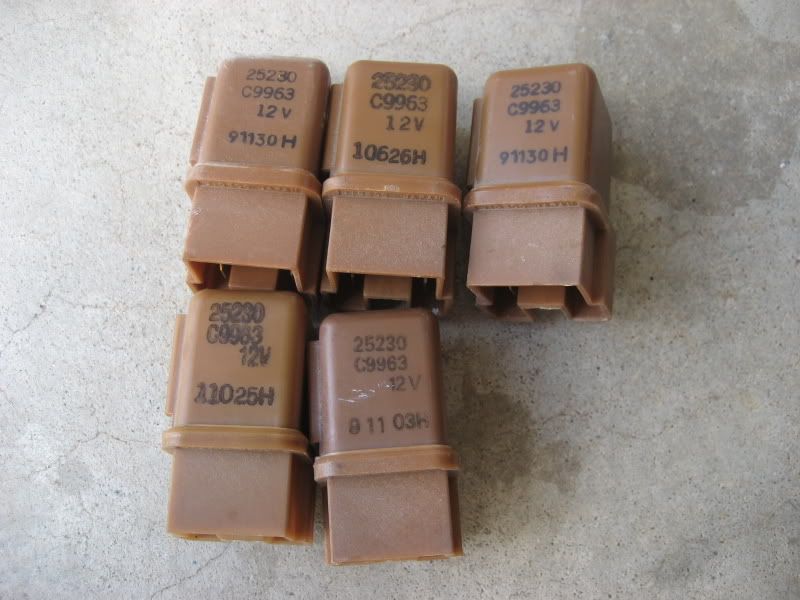

ok to clear things up once again.
do not want anyone reading this and getting the wrong info about my problem, incase others have similar.

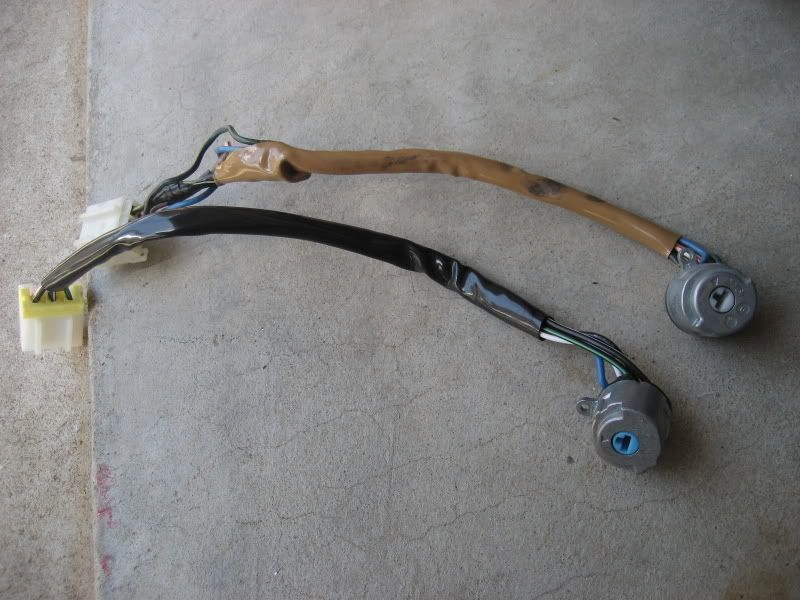

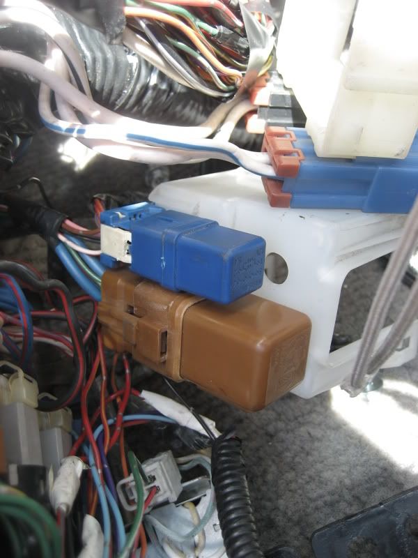

Ok So apparently my problem was still happening. The brown relays did not solve my issue. After reading the other thread i found a million times, i went back out and researched everything. Once again everything looked fine. I went out and bought a brand new ignition switch and a bunch of those brown relays (more than i needed, the more the better ). I swapped those out and i was still having the same problem. The new ignition switch did not help at all. So my last amature wiring skills knowledge was to mess with that small blue relay next to the brown relay on the bracket of the giant main plug harnesses. What do you know, my car works with no problems at all. everything works fine now. not really sure what that relay has anything to do with, but apparently from reading that other thread, it is important (i do not feel like looking it up in the fsm, lazy and tired, hehe). The guy that posted in there did the same thing and works. all i did was unplug it, hit it a few times and pluged it back in.
pics.
relays i snatched from the pull a part junk yard.

the small blue relay i was talking about.
my original switch in brown and the new one in black. (the previous owner had an alarm installed on this car and that is why the 3 of the wires are soldered like that).
time to return this sucker, and get my 41 bucks back.
