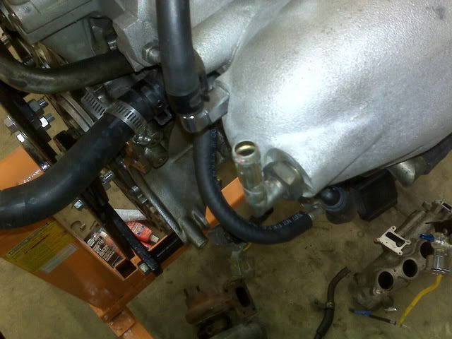

So my topspeed freddy intake manifold is leaking terribly from the swivel fittings in the back of the manifold for the brake booster and pcv. Does any one know what size threads these 2 fitting are so i can stop on the way home from work to get them! Ive been searching all morning and found nothing!

On mine its not the physical threads on the fitting that are leaking! My manifold has swivel type fittings that leak at were they actualy swivel. I want to buy fittings like the ones i pictured above that are solid and dont swivel.
Nearly any good hydraulic supply store will have the fittings you need, take yours out and match them up. The place I use has everything from AN, BPST, NPT, JIS, to standard SAE thread.

Thanks bro! you always have the right answers! LOL! I guess ill rip em out tonite and stop at a store tommorow
