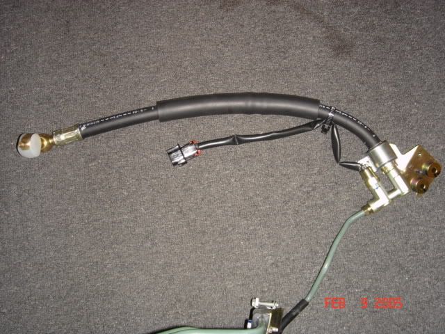

sorry for getting a little off topic, but i am gonna be putting power steering back on my car in the near future with braided lines like you guys, but i just have one question, is this wire plug/connector in the pic below important? what's its purpose and where does it go on the harness? how are you guys doing your ss lines with that plug?
thanks,
brent

we just got rid of it
DJ something talks about it in his thread either on here or nico
but it does something like raise your idle at full lock
someone with more information could chime in but from what I recall, it does something like that and that it's not needed

i was told it was a temp sensor...but ive run my s13 wihtout it with no problem for liek a year or so...

naw, it's a pressure sensor. when you turn to full lock, the pressure becomes much higher and strains the pump (thus straining the engine) which is why you can hear it struggle at full lock.
so the pressure sensor anticipates this and kicks up idle a bit to compensate. For the brief time i've run without it, it doesn't seem to make much difference.
That's correct. When steering pressure increases during idling, the idle is raised slightly.
If you don't have the sensor, the engine may stumble a bit.
Is it needed? That depends on you. Are you sensitive to noise, vibration, and harness? If you are, you shouldn't be in an S-chassis
But it doesn't hurt anything to leave the switch out.
