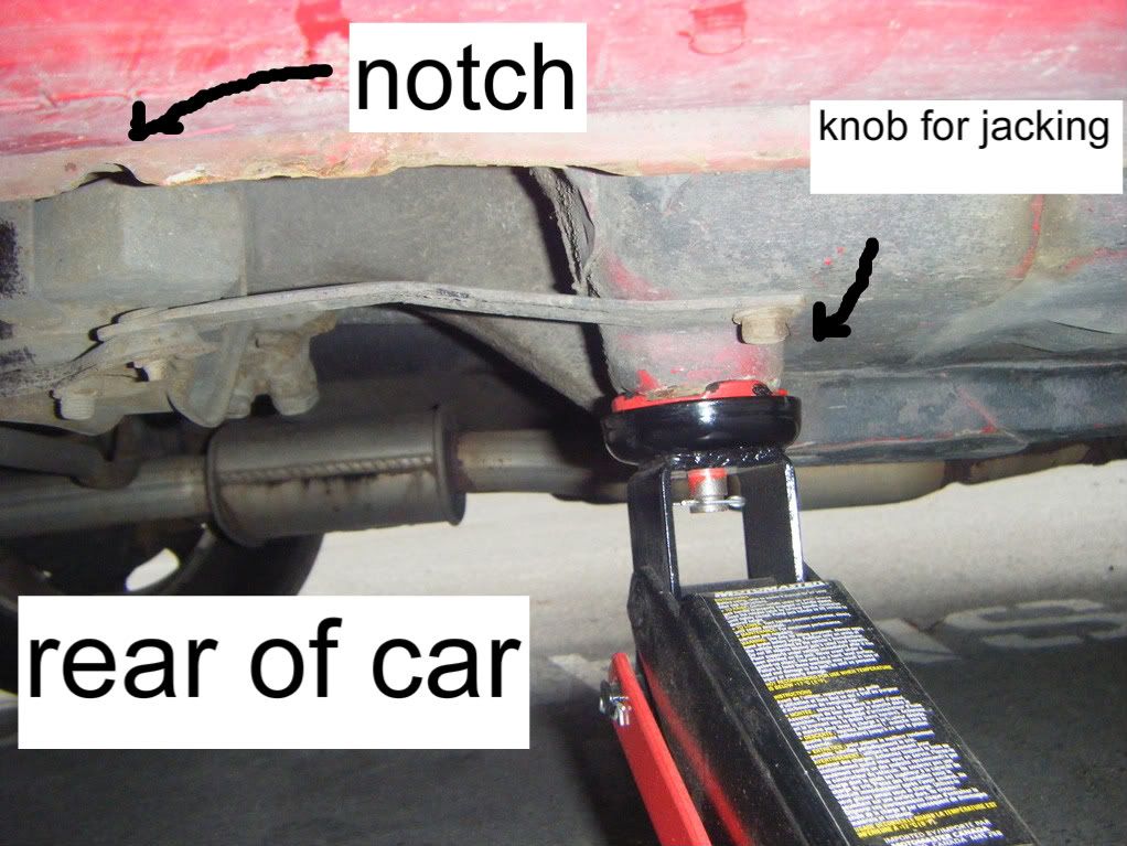

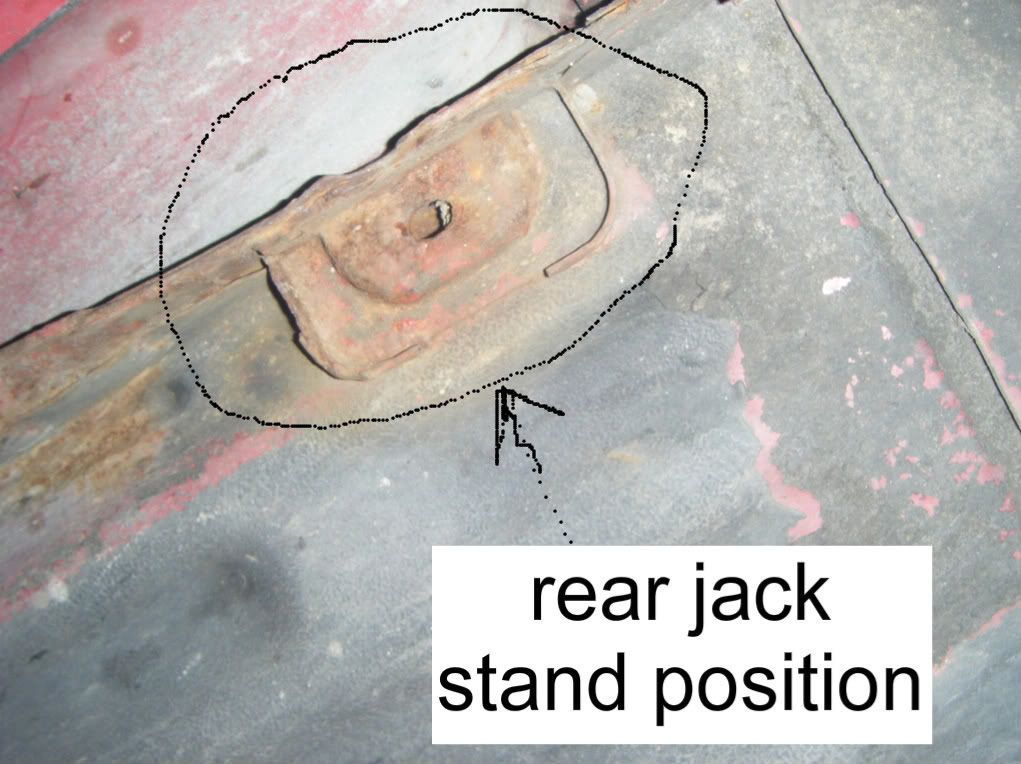

what you should know, before lifting your car
I've decided to make this thread to attempt to educate people on the design of their cars. It's come to my attention that people don't know, that their cars DO NOT have an frame-rails. The 240sx is a unibody meaning all the structural strength is from the external skin.
to read more about this structural design I recommend reading the link below:
Monocoque - Wikipedia, the free encyclopedia
these long beam type things that come down the middle of the car are called side members as you can see from the picture. This is not a frame-rail like most assume.. these are not designed to be lifted from under any circumstance.
you may ask where should I lift my car from than? from the front cross-member or rear differential. Anywhere else, and you are risking the chance of damaging the chassis.
where should I place my jack stands? again in the picture it is shown and labled "Safety stand points" but it's not as specific as I'd like it to be.
the factory service manual recommends you use a saftey stand adapter on top of your saftey stand. this is basically a rubber block with a slit/groove down the middle. This slit or groove is where the pinch weld that run down the the sides of your car lays into. I recommend you find this adapter or get jackstands that are notched to properly seat these pinch welds.
I'm hoping you guys learned something and that I see less threads about someone damaging their cross-members.
feel free to post questions and comments

There is actually a little circular lift pad at the rear of the s-13's and you CAN use the "framerail" but DON"T JACK IT UP IN THE MIDDLE! Jack it up at the front of the rail just before it starts to turn up. That is a VERY strong part of the chasis. I lift tons of 240's using those points all the time and have NEVER damaged any of them. Jacking at the pinch welds is aldo a bad idea, but sometimes is necessary on very low cars.
EDIT: I place jackstands at the very front and the very back of the rail all the time and it has never done any damage either. Everytime I put jackstands on the "safety stand points" circled in your pictures they bend.

no. he's saying that if you were to life from anywhere else but the rear diff and front crossmember you're risking damage.

the factory service manual calls front cross member the front suspension member.
i have used the round knobs at the back for lifting. they dont seem the right shape to accomodate jack stands.

You can find the jack stand postion by the notch in the seam(pinch weld) that runs from wheel well to wheel well. the position is few inches from wheel well on each end. not sure if my jack stands are suitable or that i would trust since the side member has worked. I assume the stand straddles the seam.
