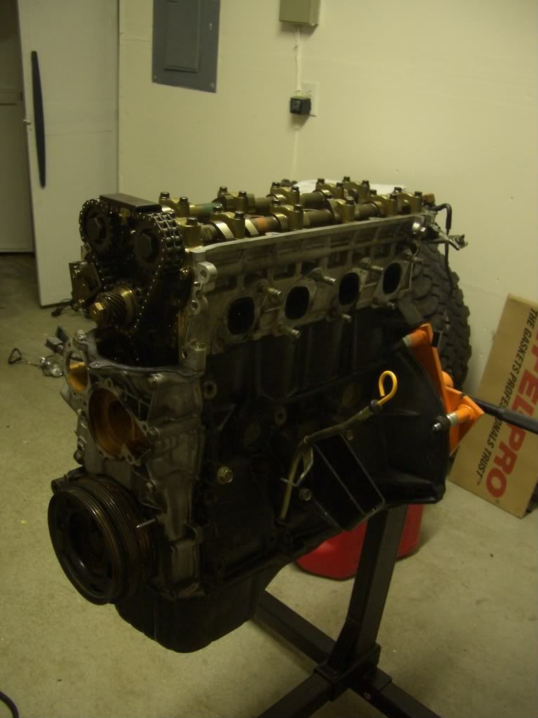

Rebuilt KA or not, you be the judge!!!!!!
So I bought this motor and its suppose to have been rebuilt 3500 miles ago. The clutch is new, pretty clean looking. It's suppose to have a full valve job done on it, new gaskets/ head gaskets, new piston rings, main and rod bearings new tming chain and guides. I got it from a good source but I wanted to take of the emmision stuff off the intake mani and that gasket looks like its the original one. I just wanna get the zilvia pimps opinions...................so tell me YAY or NAY before I break it down more...PICS in just a few minutes.

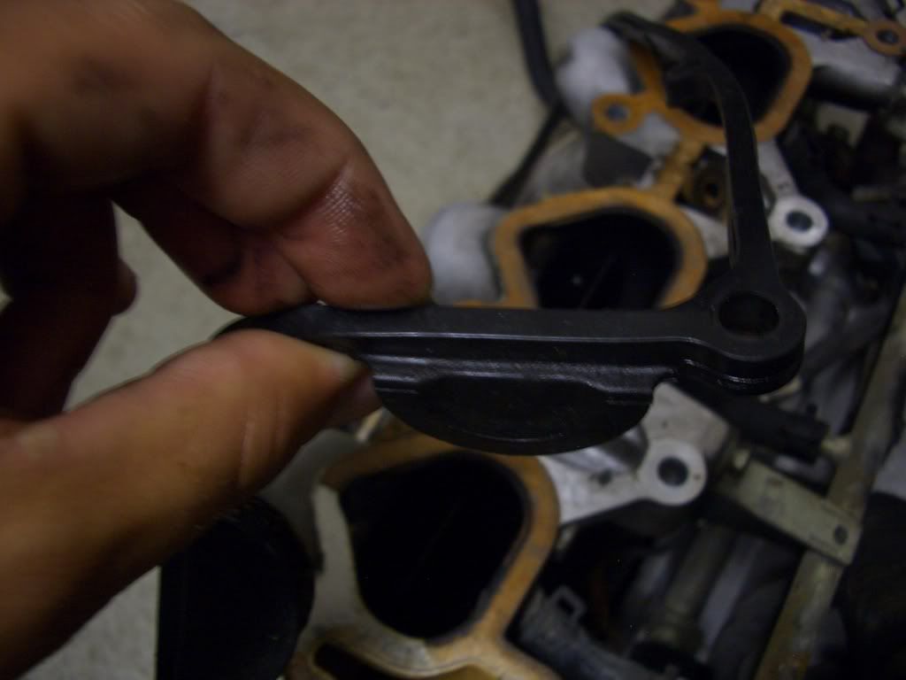

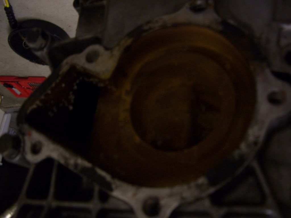

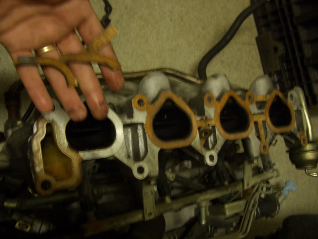

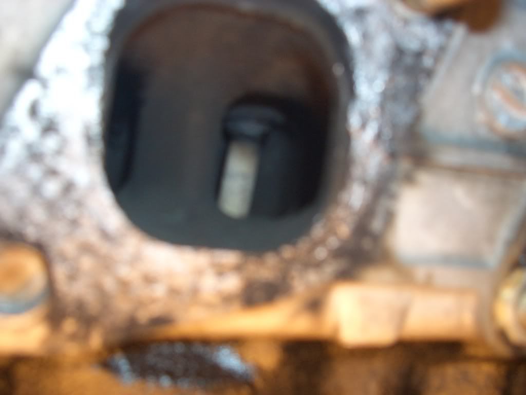

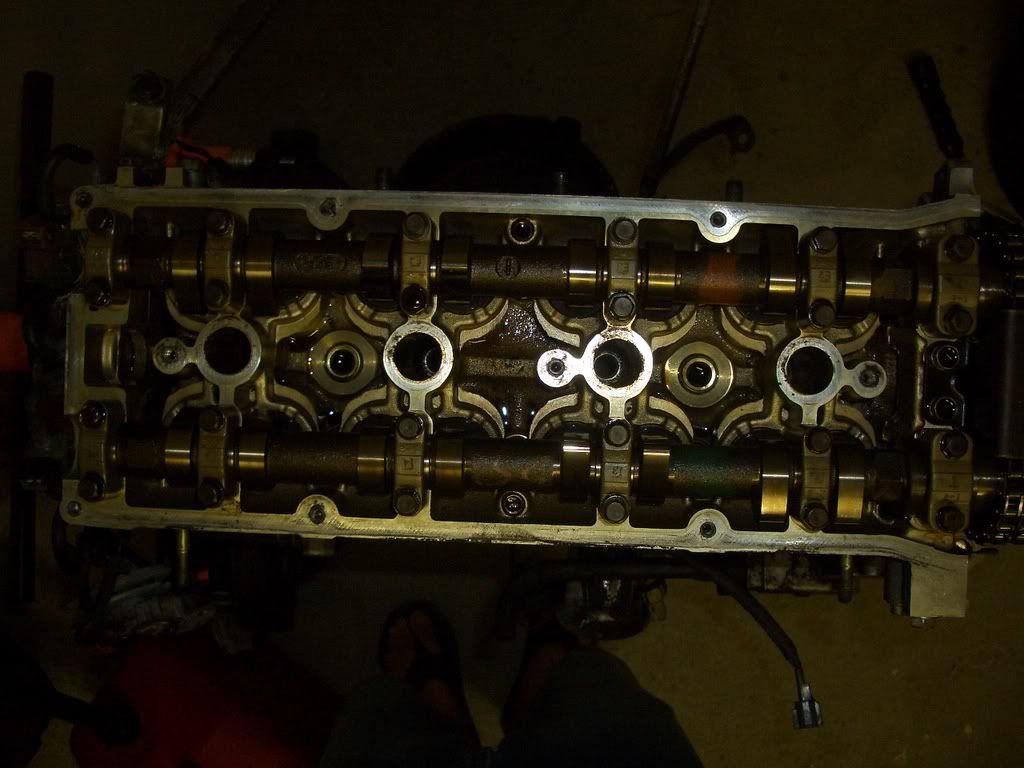

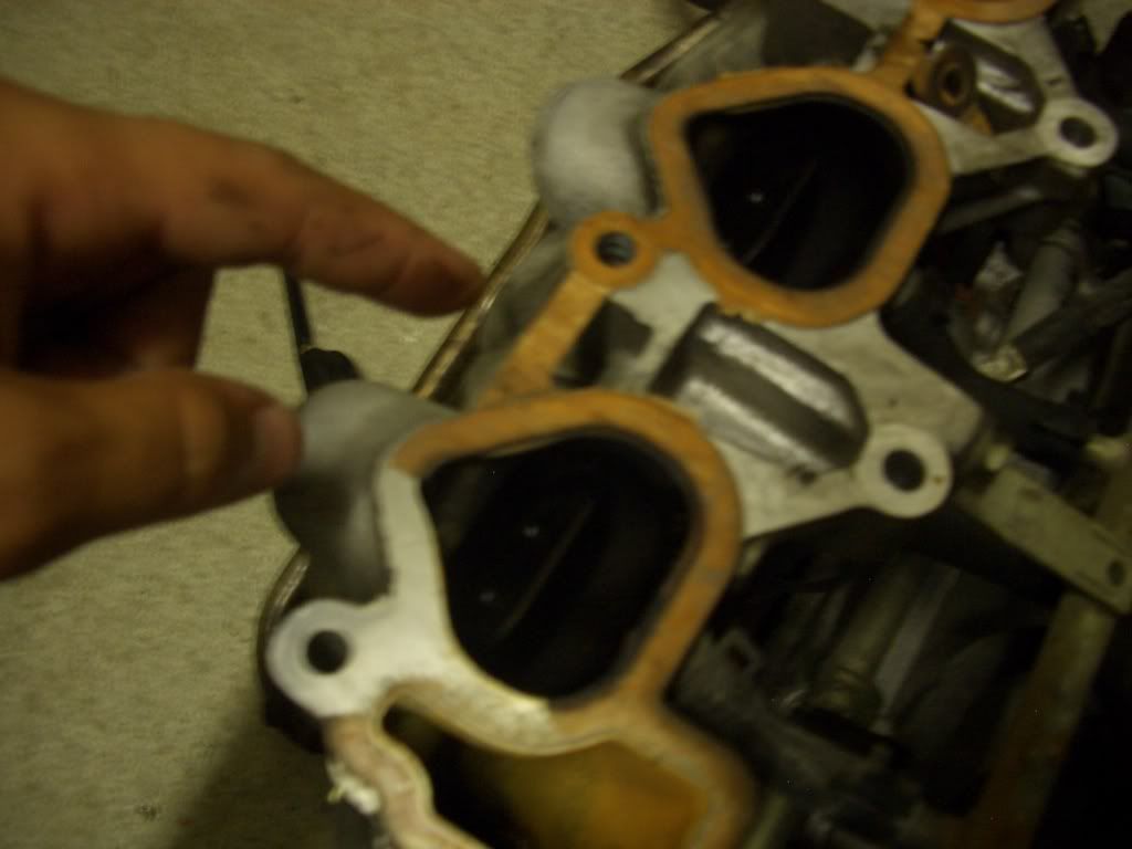

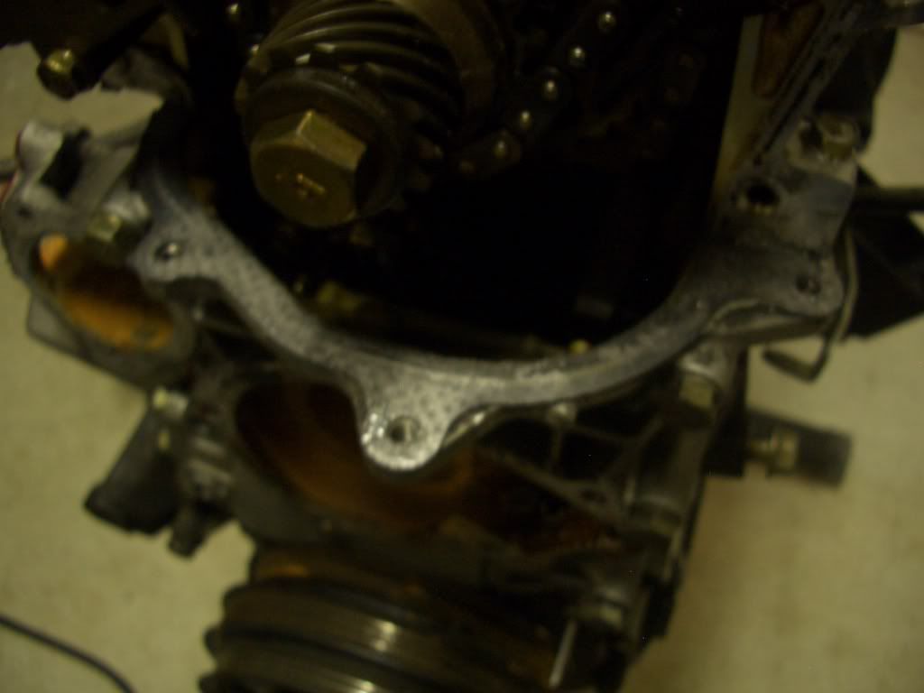

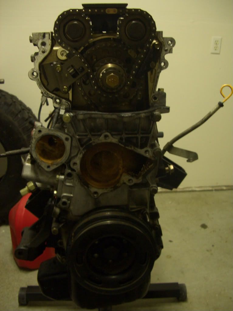

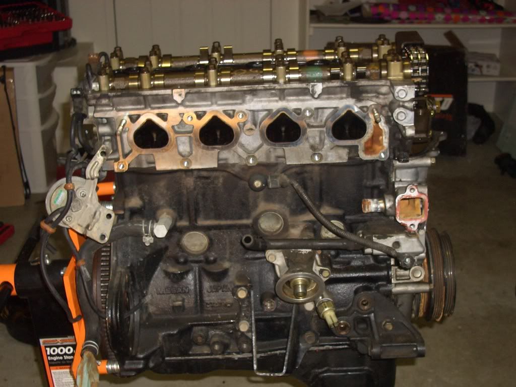

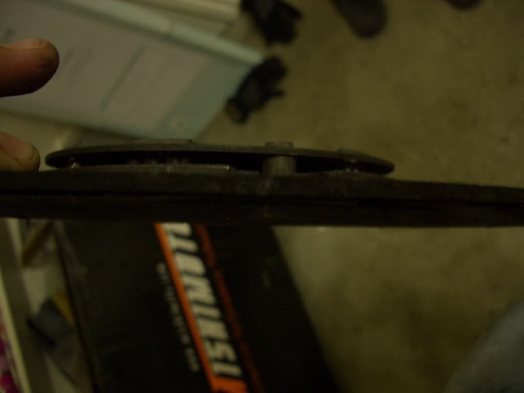

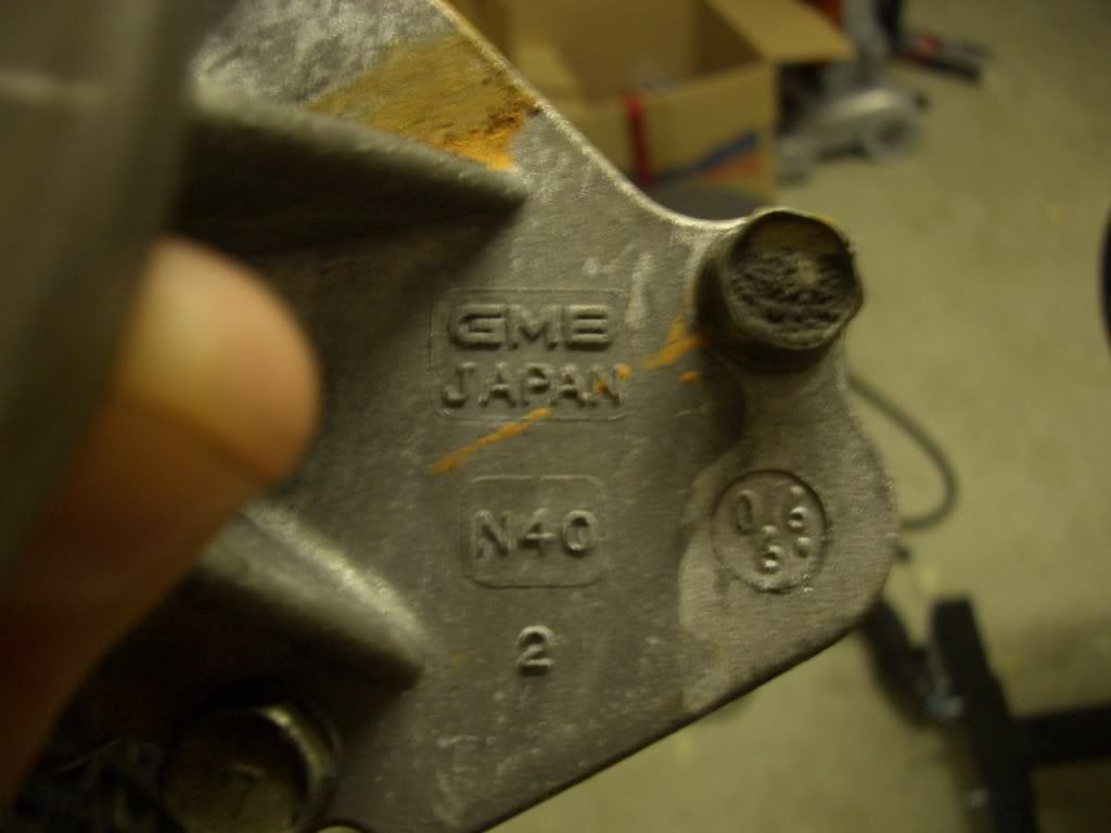

OK-K-KAY here are the pics, soooooo should I keep breaking her down or what?

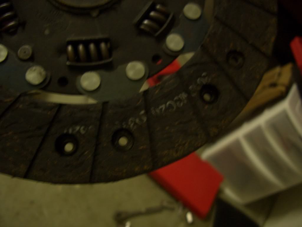

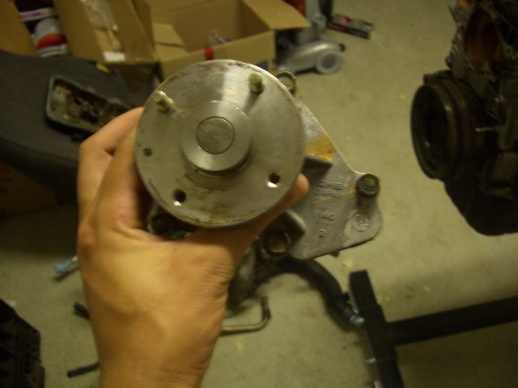

Clutch is new, water pump was told is new, it has the exhaust gaskets looking new. I don't really know how to tell if the timing stuff got replaced. The headgasket I guess could be new, maybe?? Let me know what you guys think, pics upon request.

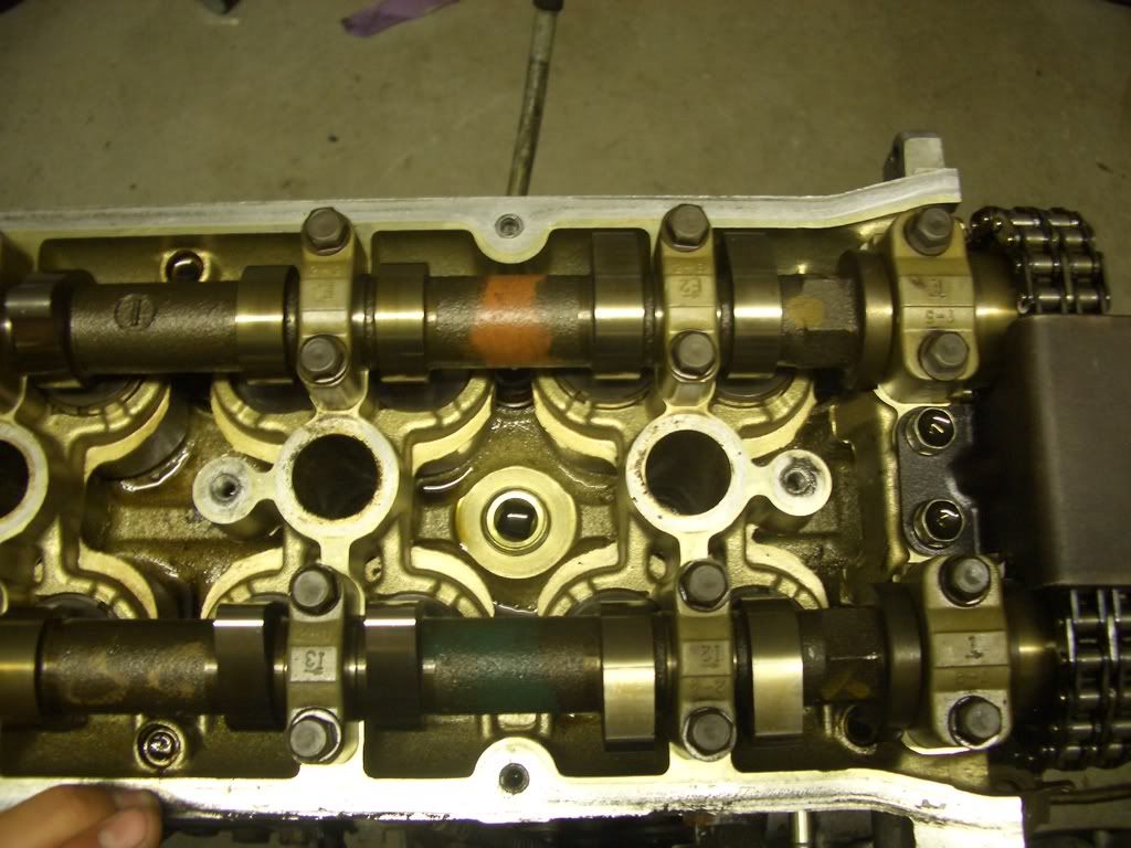

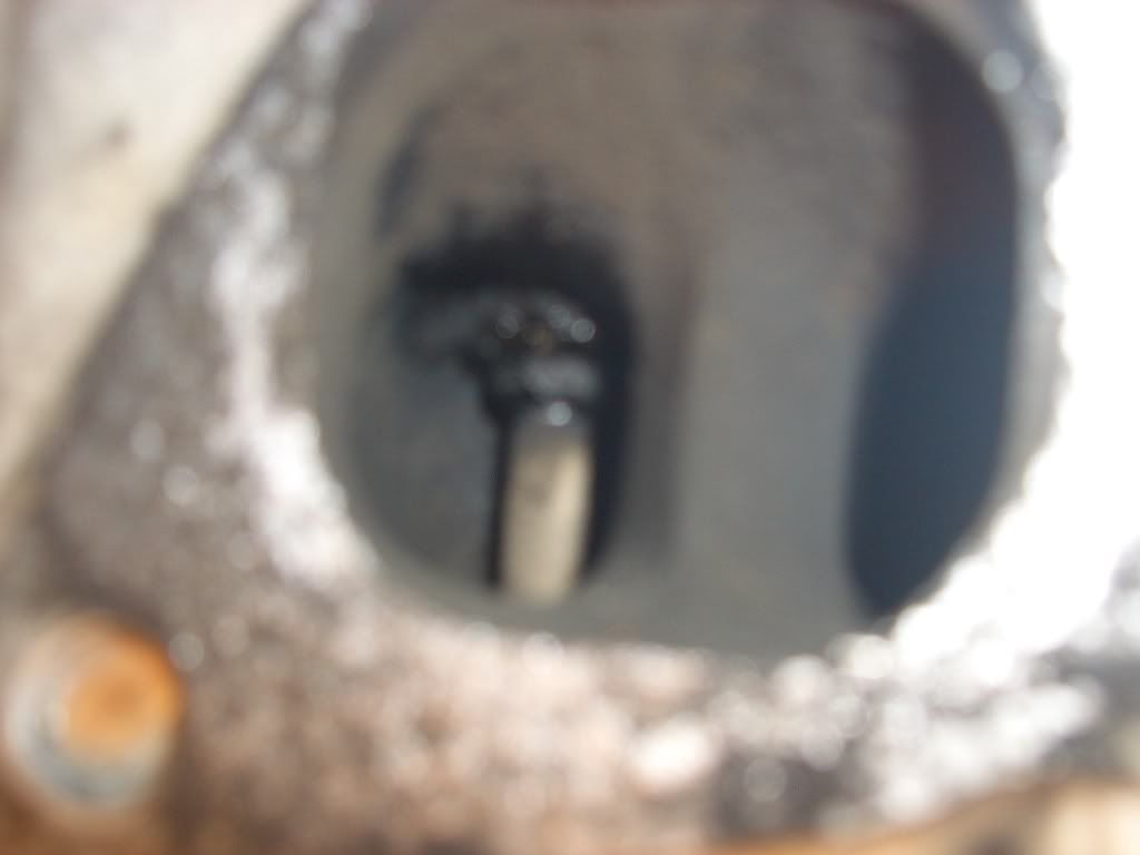

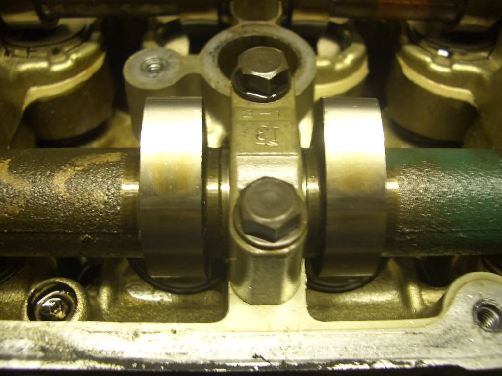

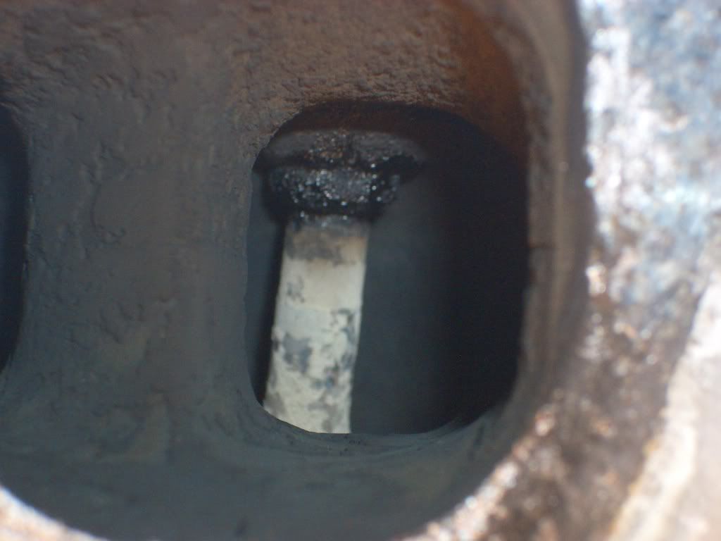

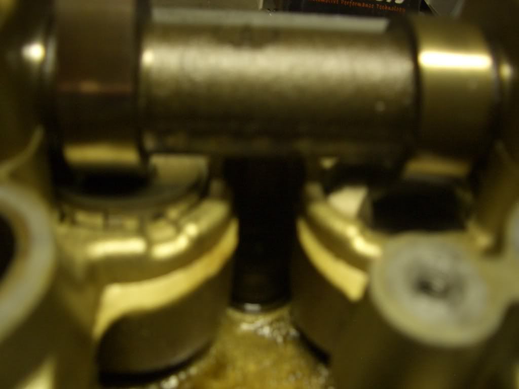

water channels look frickin gross.
that head looks like its been hot tanked - when you look by the cams all the oil is gold and there's no nasty brownish burned on residue like you would see on an engine that hasn't been.
Looks still dirty though and it doesn't look like they really took the time to go the extra mile.

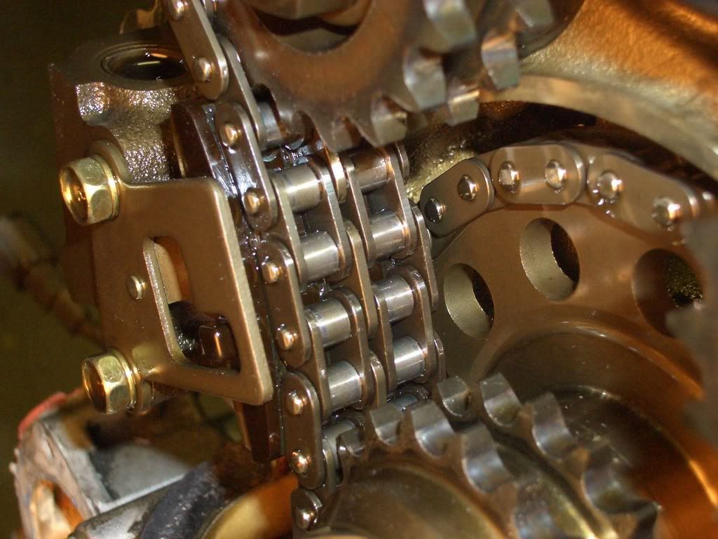

In comparison here are pics of my sohc when I just did my rebuild:
tastyratz/engine - Page 1 - Photobucket - Video and Image Hosting
I also went completely overboard with that too as you can see.

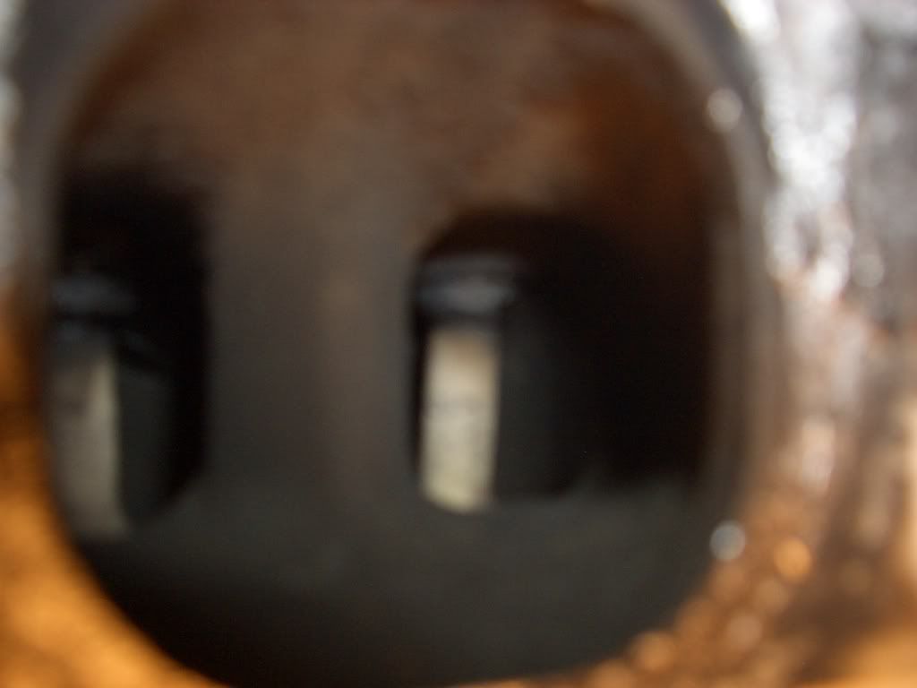

Looks like a half assed rebuild if you ask me. Been sitting awhile? That waterpump and channel on the front cover look more like rusty sawdust than clean and fresh.
Those exhaust ports are friggin GROSS. Looking at the buildup there they didn't do valve seals/ (or guides if need be) but you should before you put it in.
Get some cheap brass freeze plugs while its on the stand and out of the car.

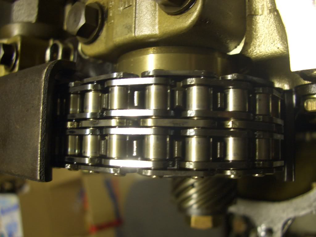

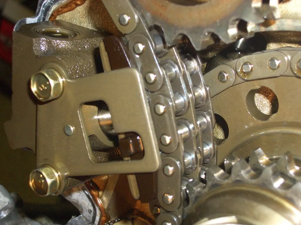

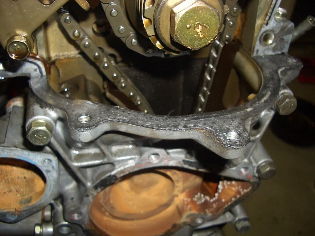

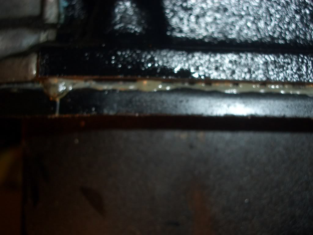

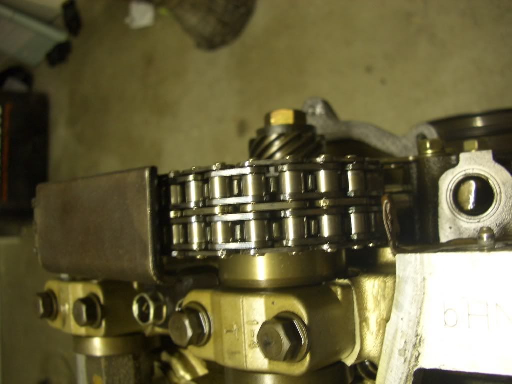

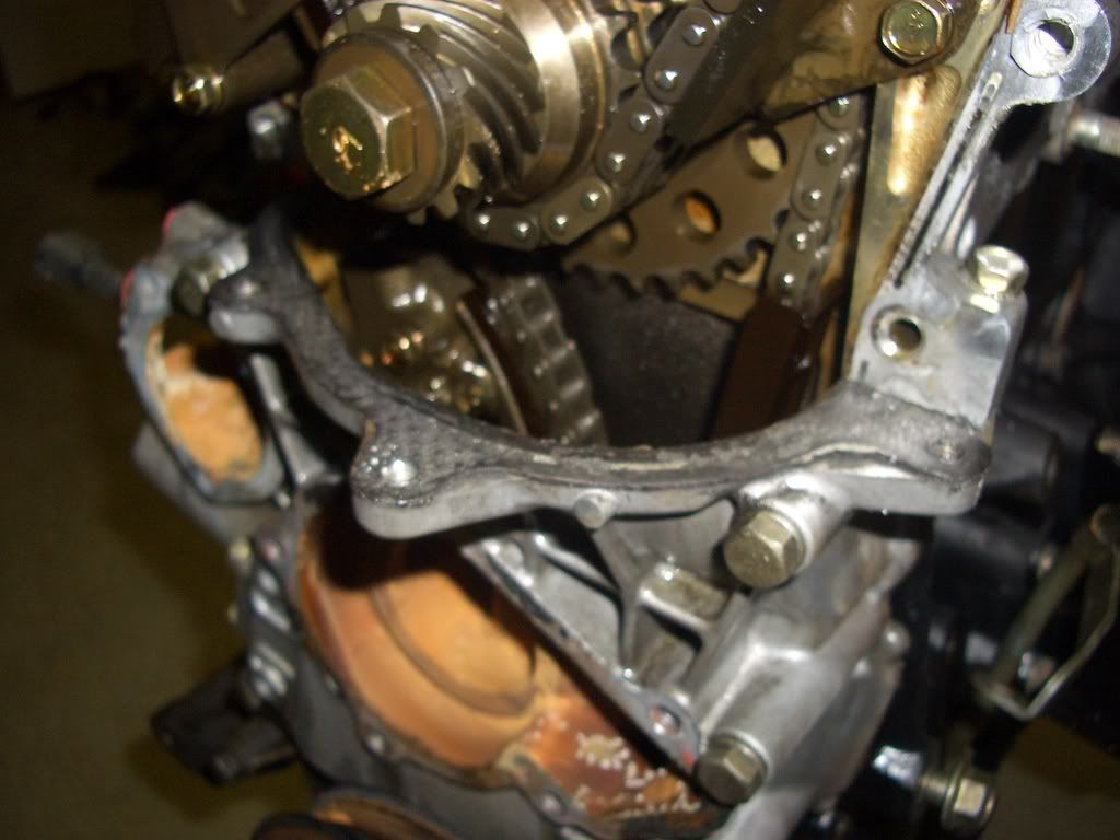

Looks like the only thing done to it is a 120k Timing Job. Why they put the top guide back on I dunno. Water Pump is not OE and it looks to have sat with plain water in it for a year or more. I've had motors sit filled with 50/50 anti-freeze look like brand new aluminum in the front cover after 2 years.
The Head Gasket and Bolts are stock and I doubt the Head has been removed. Head has not been hot tanked. Would look brand new if it did, not that golden oil vanish color. Probably just sprayed with a pressure washer to get the sludge out.

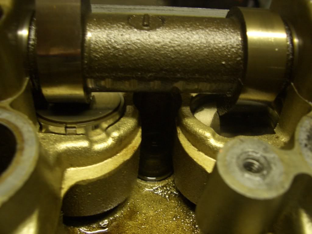

No "Valve Job" has been performed. Can see oil leaking from the stem seals. Who Reuses the stock valves? All those deposits are not from 3500 miles.

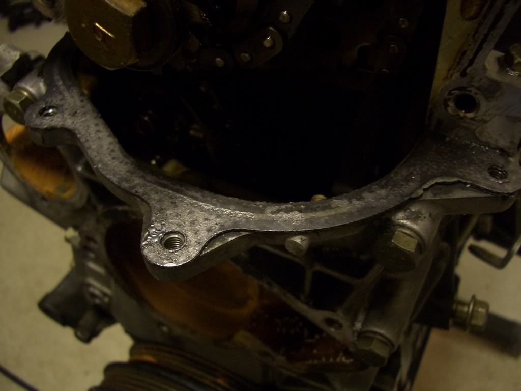

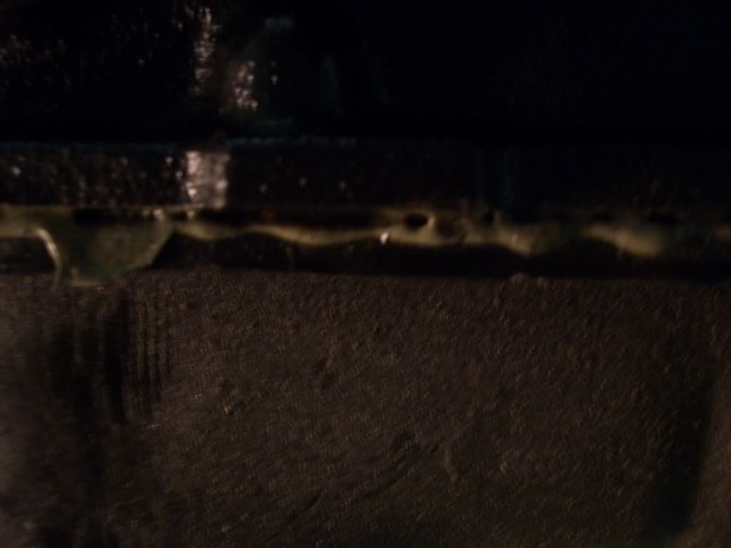

That oil pan sealing looks like shit so you may as well take it off and redo it and take pics of the crank, mains and oil pump.

You got hosed. That motor wasn't even hot tanked which is something they should have done when they had the motor and head apart. Absolutely filthy, no way it was rebuilt 3500 miles ago.

hahaha omg wow... yeah dude break it down and rebuild it. The head is full of carbon and you can clearly see white residue all over the valve stem. Either running too lean or rich in that cylinder or it's from detonation.

Agreed with all. Someone used a few cans of carb cleaner on the head and timing components and called it rebuilt. Nothing on that engine is new.

Like everyone else said, looks like the just did the timing chain stuff, but the gears look kinda worn. I dont think they even touched anything on the head.

Get a new OEM oil pump/front cover. Get a new OEM water pump too.

dude that motor is kinda hurting, when the valve seals are leaking that bad you should know its not from 3500 miles of use. My motor that came out of my car before I did a through OEM rebuild had 165k on it and didnt look that rough, even the head looked cleaner than that, but I did change my oil very frequently.

that water pump looks like shit
