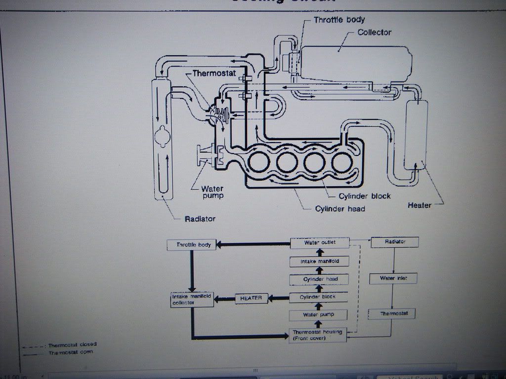

have you run without the stat?? your interior heater is blowing cold air. thats a pretty specific symptom. the stat is what opens up to allow the hot water to move to heater.
Thats 100% wrong. The coolant moves from the engine to the heater then routes back into the engine if thermo is closed. If your heating isnt getting heat then inspect the linkage that controls the heater.
Bigsyke is offline   Reply With Quote
I was thinking of my old car. this is the 240sx manual
