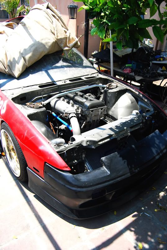

you can still use your koyo, i did.. here is a few pics of my set up...i would say hit up luisgonz but his banned.

how much fabrication was involved? i know i will need a new intercooler, piping, and new radiator hoses, but mounting everything up is very foreign to me.
having custom piping made is no big deal, i just dont know about anything else.

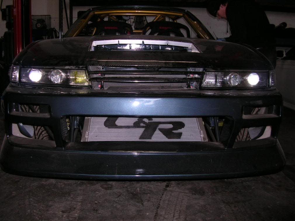

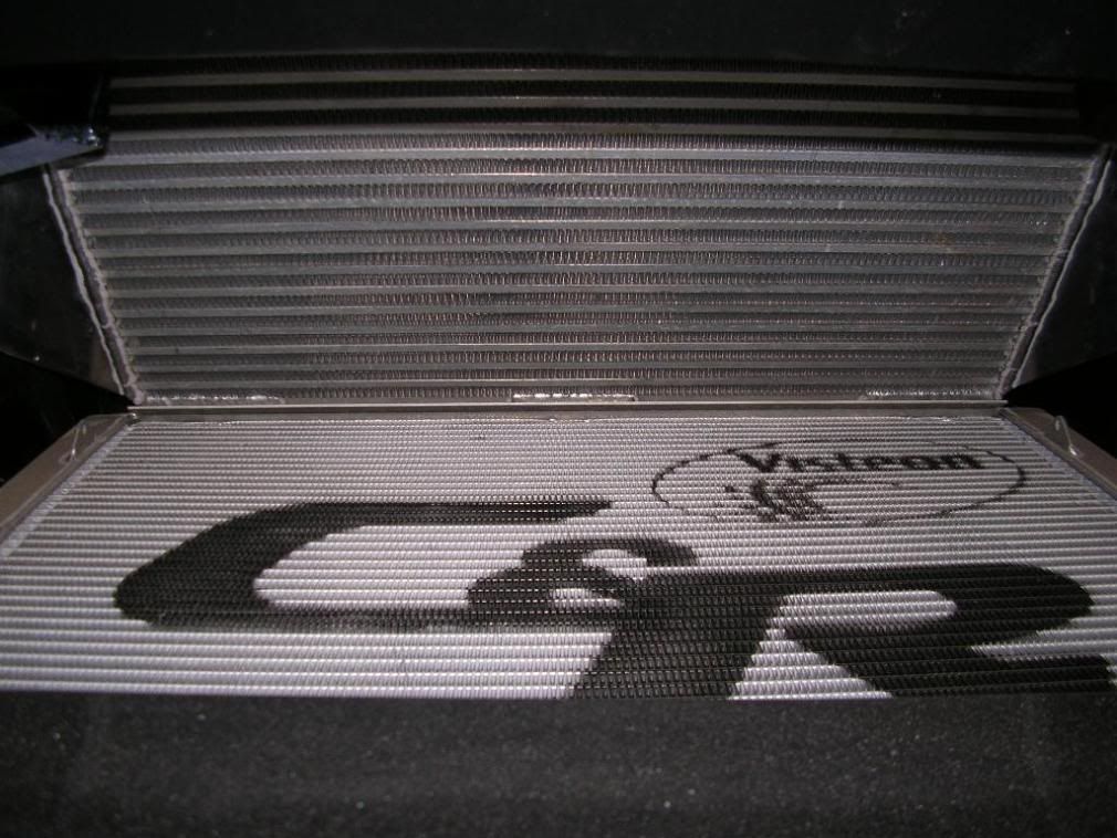

Id stick with a FMIC if you want reliability in cooling.... But yeah here's my old Vmount kit... was around 2,000USD all up from a company who was making proper kits using Garrett core's and proper radiator cores... you can't see much but yeah lol.

yup that looks like a 7 mount lol... not a v mount.
