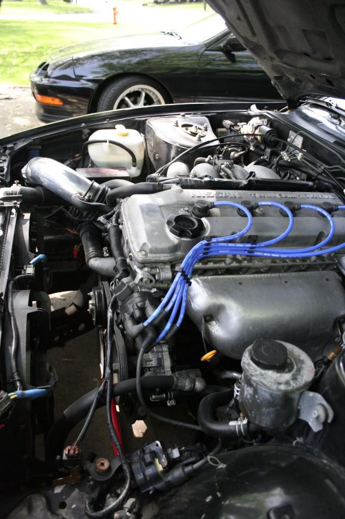

I know this topic has been covered to death, but I've searched around and idk what I'm doing wrong.
SO I picked up a '95 altima dual fan setup from a junk yard, and tried to drop it in... its' like wayyyyy too wide. SO I whip out my dremel and start trimming away at the shroud. It totally doesn't clear the a/c lines on the pass side and the a/c and power steering lines on the driver's side. I relocated the power steering line so that the fan clears on the drivers side but it still hits the a/c condenser (? - dunno what its called... round metal thing) on the passenger side. I got the shroud trimmed to the point where it clears fairly well, but the fan blade hits the a/c parts on the passenger side. Clearance is maybe 1/4" and if anything shakes it hits...

hey clear both AC lines, and PS lines. Gotta get crafty with the dremel, and they'll fit.
The bottom poles don't line up but who cares. I attached the top to OE bolt locations through the altima fan. Had to redrill and trim, but came out super nice. (Gallery :: Engine Bay :: IMG_1898 and you can see what I did)

hmmm have any better shots that show a/c / power steering line clearance?
