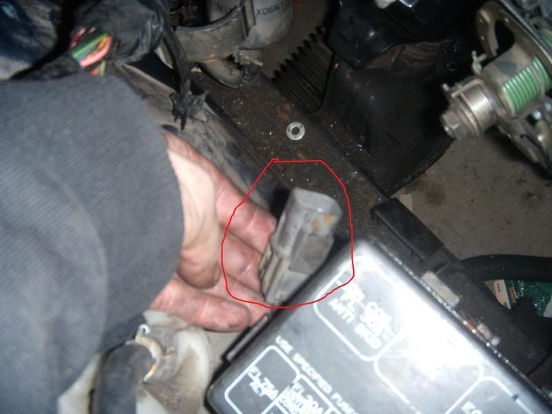

Ok this is my 1st motor swap and alot of wiring/powertrain was missing from the car when I bought it, so I'm having to figure out alot by myself. 89' 240 with a dual cam swap. Got everything in ok, but when I tried installing the harness I ran into some problems.
FYI- i removed the power steering and a/c
plugged everything in i could find, but have some connectors left over on the harness (some prolly go to ps and a/c) and i also have a bunch of connectors left over on the actual motor itself.
These 3 connectors are coming out of the fuse box. what connects to them? tranny harness? harness from alternator to battery?

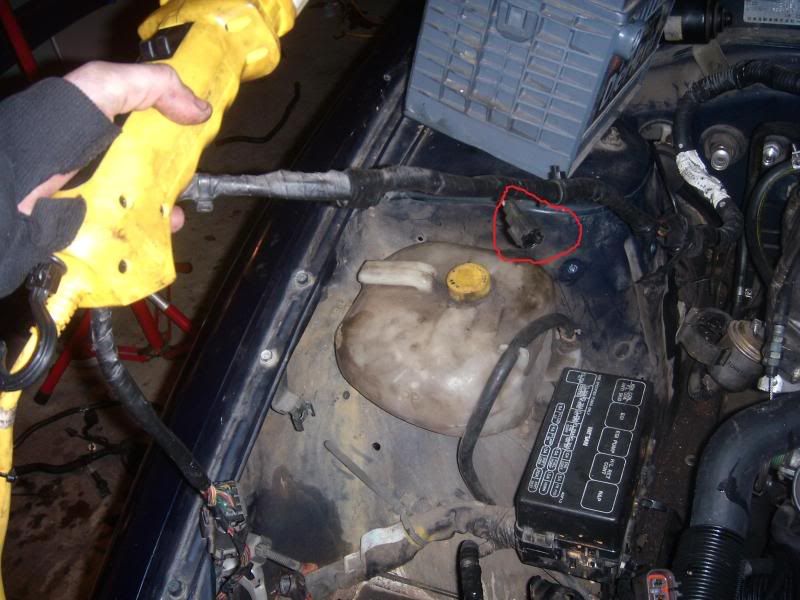

also coming out of the fuse box on the other side of the box from previous pic

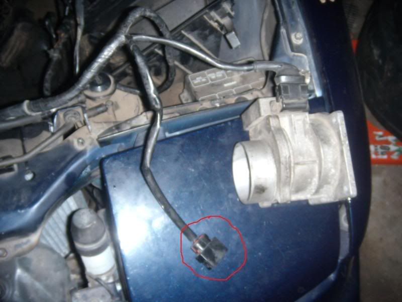

2 wires branch off. one goes to maf and the other??
number 1 goes to the coil. number 2 and 3?

1) Lower harness plugs to alternator, transmission, starter.
2) Same.
3) P/S high pressure switch.
4) Coil and power transistor. You need to use a DOHC coil.
5) P/S pressure switch again.
