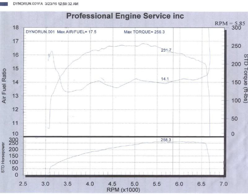

Im not sure about anyone elses 3700cc's but on my Old Stock Setup @ around 11psi mine leaned out on a T-28, Stock EUC, 370cc, Stock SR Fuel pump/FRP
No corners cut on my swap. But im sure with a Walbro and a Adj FPR you can squeeze a little bit more fuel out

I made 286 hp at 16lbs with a T28 on my SR20VE-T ( its in a 200sx SE-R) and my duty cycle was at about 92 percent. That fuel pump is definitely not hacking it for fuel duty. Some people run them but a Walbro is only 100 bucks and its cheap insurance.
TheRealNighthog is offline   Reply With Quote
I thought that head would have made a bigger differnce,
You do know that 92% DC is not good right?
It wasnt the only the pumps Fault when ever i hooked my PFC up over 11PSI PFC showed 100% DC
But that was all on my stock set up and that dyno pull was for information purposes
