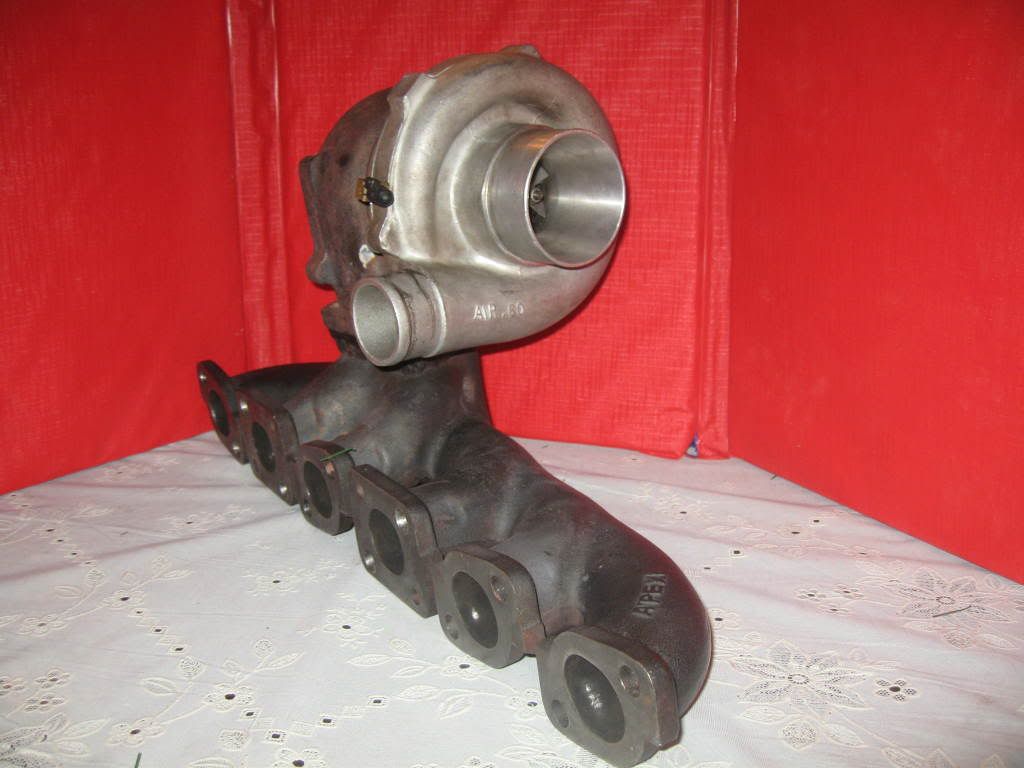

RB20/25/26 manifolds

I did a GB on nico last year where we got the Australian 6boost manifolds for about $750 shipped. It also came with new exhaust studs/nuts and a turbo flange gasket. Each was custom made to the customer specs, on mine fitment was perfect. Too bad the dollar took another plunge or I would do another GB.

^^^ That's awesome! I would love to have a custom mani made - I've been tossing the idea back and forth with Neukin to make a twin-scroll/single gate T3/T4 manifold for a while, but I don't think he could get anywhere near $750 - and Full Race wants $2200+ for theirs lol.
Definitely a nice manifold you've got there.
