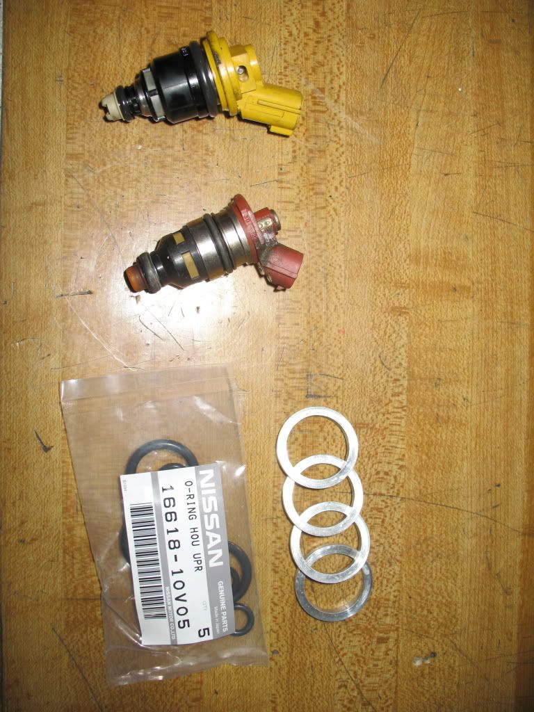

Long story short i have two fuel rails both with 4 270cc dohc ka injectors. My problem is that one rail has cream color plastic nipples at the ends and one of them is broken like someone dropped the injector and the nipple cracked.
The second rail is similiar except instead of complete circles all four of the injectors have just a circle with 4 little pegs that dont really seem to do anything. On the peg rail i have one of those little pegs broken off. So what is the point of these little nipples on the end of the injectors.
I am assuming they are for sealing to the intake manifold. Would it be alright if i just mix and match the rail and have four unbroken nipples or what should i do. I can provide pics if necessary.
Edit: Here is a really good picture of what i mean. Top being the four peg and the bottom being the complete circle nipple.

they are supposed to help with atomization, but they will run just fine if the tabs are broken. You CAN mix and match, just as long as you know they are the same flow rate. You may want to send them to RC Injectors and send them out to have them bench flow tested, make sure they're not clogged, dirty, and don't need replacement.

i pulled a dead injector a few days ago. it probably looks similar to yours:
as far as i know the ones with one solid piece and the ones with the four pointy things are both 270cc and do the same job... but i've never seen a broken one with the one solid pintle cap. i'm going to get a set of four of them together and send them off for cleaning, i recommend you do the same

the yellow one looks like a hks 550 injector

The pintle cap does NOT help with atomization. The pintle cap is there to ensure the lower o-ring does not slip which could result in hydrolock. If you dont know, then dont answer.
This is how NOT to remove your injectors...
it's also not how it was done. i use vice grips to turn them and then pop them out with a washer and a flathead.
Lol, cool, but shouldn't be turned either. If you pull them straight out with a flathead, you can usually re-use the O-rings. Twisting can tear 'em on the way out.
eh, fair enough, but i'd rather just pay the dollar to replace them anyway >.<
