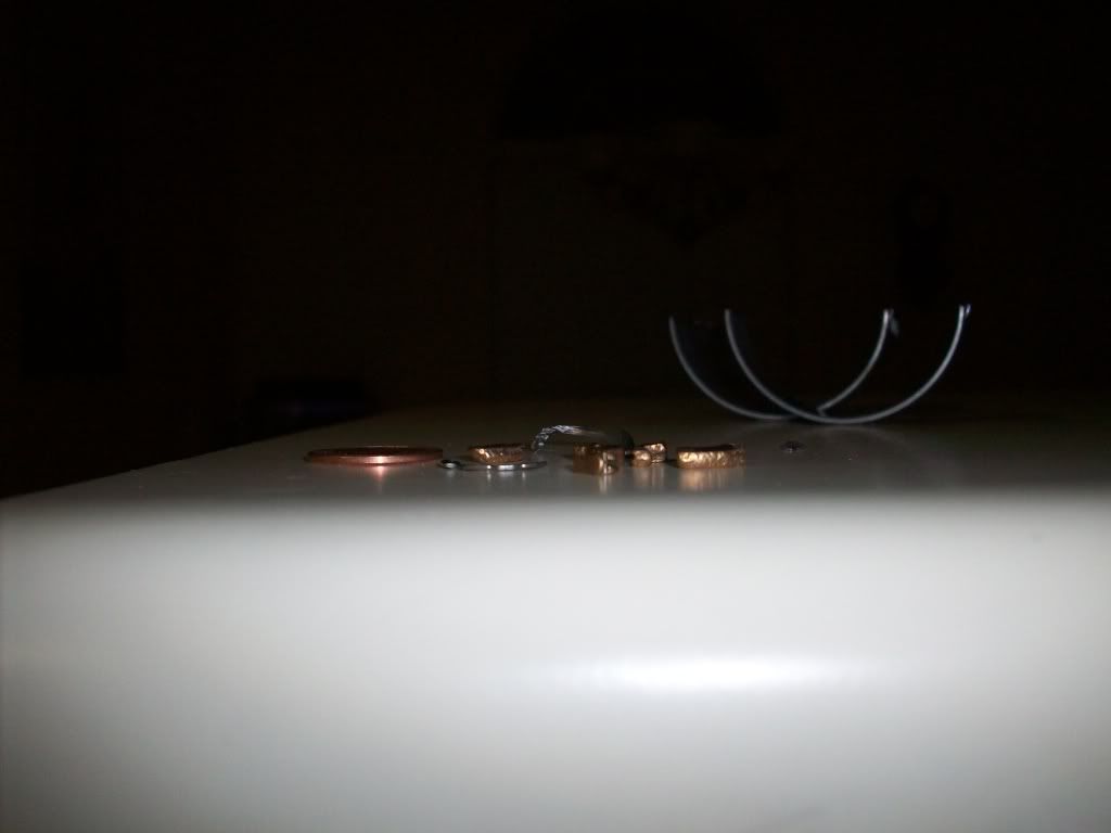

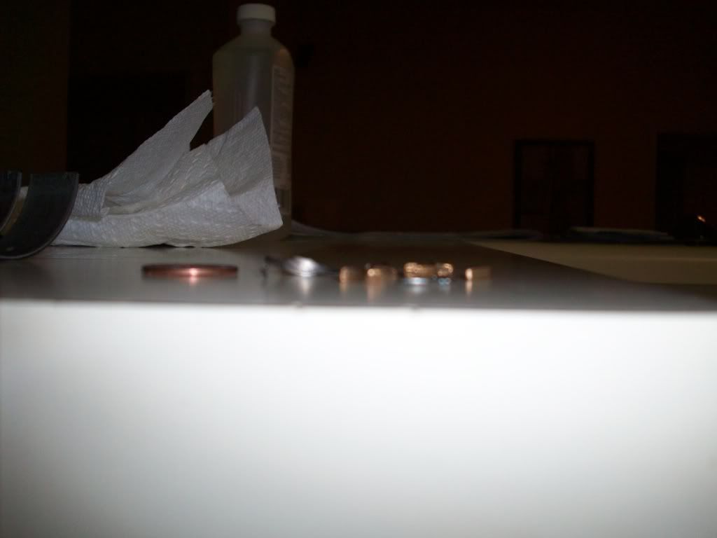

So a friend of mine's SR developed what we thought was a slight rod knock the other day. After pulling the oil pan and replacing them one by one they all looked perfect. We were about put the oil pans, windage trays, hardware, etc... in the dishwasher when I noticed some small pieces in the lower oil pan. After pulling the valvecover and looking around the crankcase and head we are stumped as to what it might be/ have been. Maybe part of the oil pump? One of the pieces in the picture (silver in color) appears to be a c-clip. Anyone with in-depth experience of SR's please help us out!

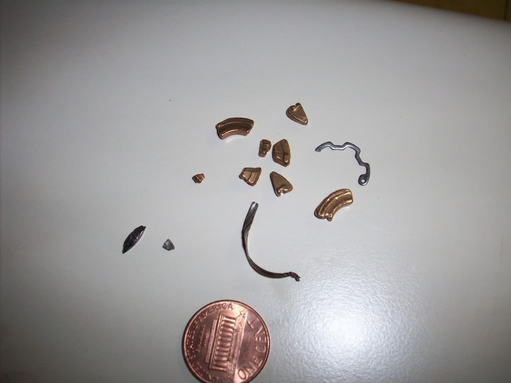

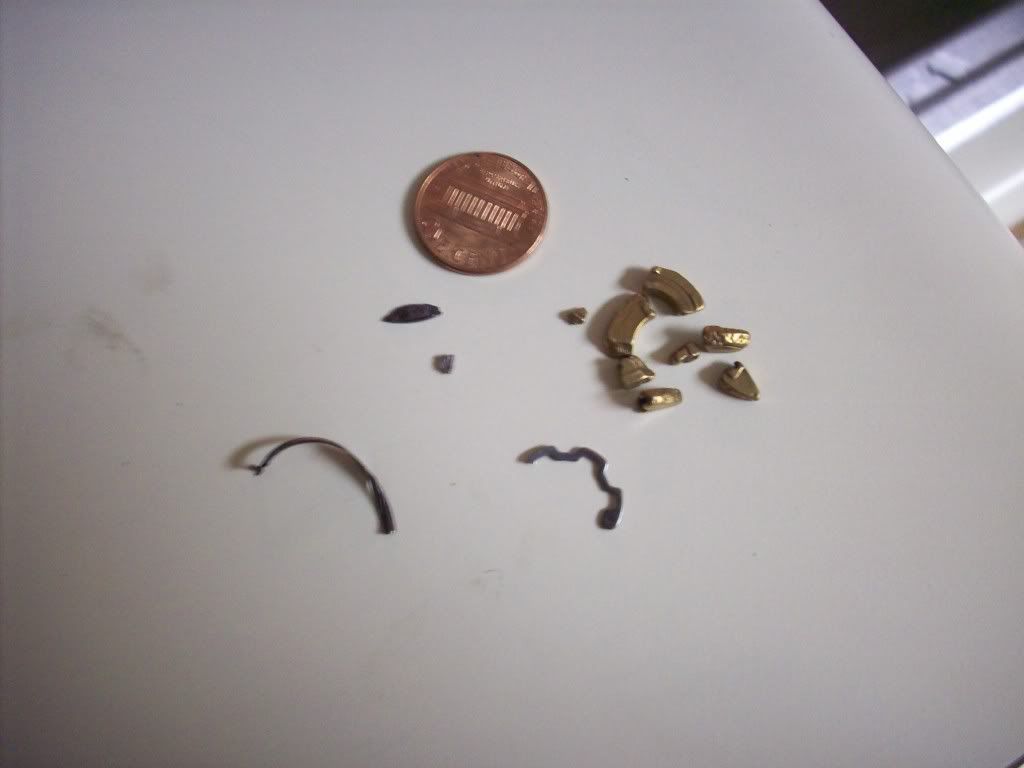

I had to google "macro" to know what the hell it was, lol. I'm a newb to cameras/ photography. Better (much better) pic added.
If it were a valve guide I don't think it could make its way to the oil pan. The pieces would just bounce around in the combustion chamber, sound like horrible detonation and score the cylinder walls.

looks like pieces from the T25 turbo, the journal bearing and the bearing C-clip
it possible since the oil return is fairly wide enough.
the silver one is also part of the turbo's bearing retainer clip (spiral clip)

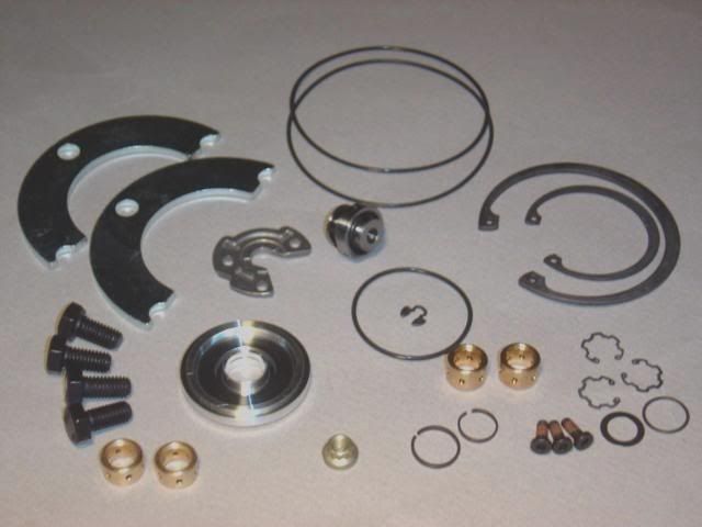

Ding ding ding, I think we have a winner. I'll go tear it down today and see. Thanks.
Edit: I don't think I have to. I found a pic of a rebuild kit and you are right. I wouldn't think that it would be rebuildable though with chunks of metal spinning around inside it.
