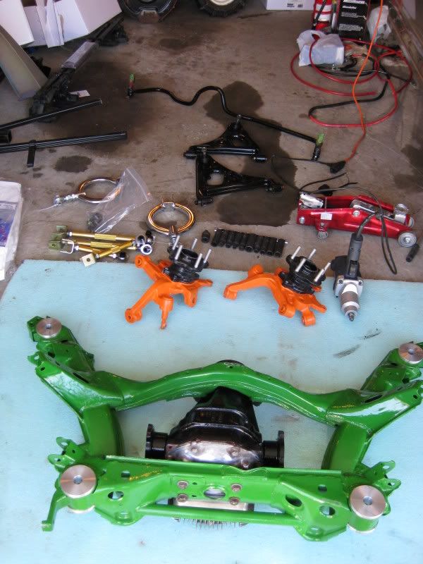

you can drop your rear sub frame and do solid alumn bushings like this
or you can buy slotted sub frame collars and just lower the sub frame and slide them in on the bottom and top of the stock rubber ones. the most simple way thats for sure

Sorry but solids are the way to go on an S14, there is nothing that will match them.

Agreed solid subframe bushings (I bought PBM subframe risers to get some geometry correction) and poly diff bushings are the best of both worlds. Solid diff bushings make noise/rattle a bit.
