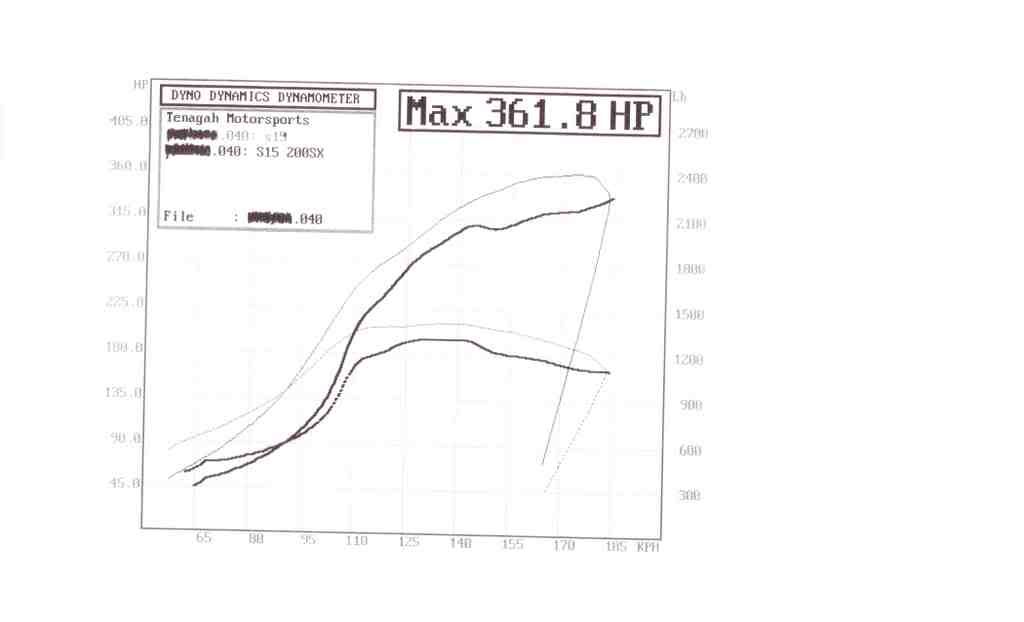

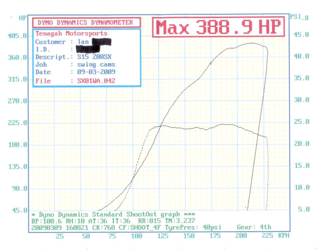

These are the only dyno's I have re the tune which as you can see were done a while ago. The tune was never completely finished because my tuner was borrowing a dyno on the day and ran out of dyno time. Also need to fix up the boost drop in the top end. Note the ambient temp was around 36 degrees when these were done. I have had it on another dyno since in cooler conditions and it made a couple of more psi across the board at the same rpm - for instance it was making 26 psi by 4000rpm - no printout to show unfortunately.
This dyno done in 4th gear - (5th is 1:1 in my car as I have a 6 speed close ratio Nismo box).....also shows 24psi by around 4000rpm even in 4th....5th gear (1:1) is better still.
Same dyno as above overlaid onto a different s15 with single scroll 3071 ex gate on 6boost manifold 256/256 poncams and stock intake.
This dyno done in 5th gear (1:1) after retarding the ex cam a couple of degrees - picked up more low and mid and lost top end - revved to 8,000rpm although shown in klm/h. Notice how it holds up power reasonably well at this rpm even with the 260 hla's......in any case the power nosing over is more likely attributable to the boost dropping as show in the dyno. Boost curve in general is a little rough
I know the scaling is crap on the horizontal line. One day I will get a better printout.

That setup seems quite laggy too, you are making sweet fuck all power at 4000rpm and you claim thats full boost.. Who cares what "BOOST" you are making at LOW rpm it's about POWER @ low RPM...

Haha if i wanted power low in the rev i wouldnt be wasting my time with an sr.
Anyway mine makes around 180rwhp at 4000 which is as good as most 2871R's with similar cams and I have more top end.
I also ditched the stock intake and chose the Hypertune intake for a more linear power delivery rather than a more focused hit of torque in the mid-range. Plus it runs a full exhaust and legal cat which no doubt impacts on the overall power curve.

Yes, you are right HKS use the T25 size on their 3040 (similar to GT35) and its a laggy thing. All their other turbos are smaller sized which is better suited to the T25 flange size. Having said that even a pair of HKS 2835 twins on an RB26 is slower to spool and makes less power than a GT35 with a T4 1.06 open housing.
I've had a T25 Tial flange housing and based on my calcs the opening is no bigger than a T25 Garrett from an area point of view.
Back on topic .....you gain response with the staggered setup - 256/264 HKS and Greddy Easy Cams for instance are common as well as 264/272 HKS staggered setups.
A few people in OZ initially used the Tomies 270/270 then swapped the inlet back to a 260 and noted an improvement in response for street/circuit duties. Also Camtech cams make a 255/260 combo and with a T3 .63 3071 20 psi is reached by around 3600rpm on an unbuilt SR20.
I think the smaller intake improves the spool which in turn leads to better cylinder filling and therefore torque/power at lower/mid rpm as evidence by numerous dyno's.
