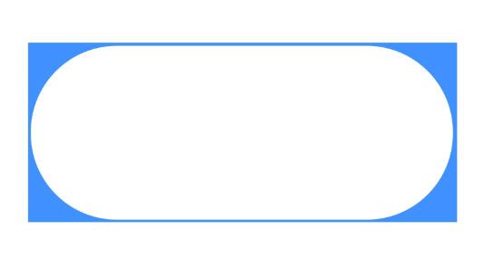

Originally Posted by fckillerbee View Post
are you talking out of your ass, or do you have a physical proof of this?
i mean...space is space. if they occupy the same amount of space, I don't see one flowing more than the other.
the cross section of a square pipe gives you a little more area... ( the blue space ),
Assuming they're the same width across and height from top to bottom... the rounded ends rob you a little bit.
