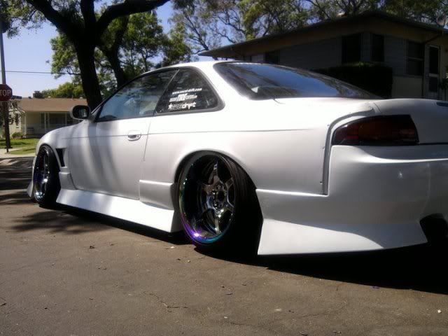

Anyway here's a pic of it before. I did NOT touch the height adjustment but somehow when I removed negative camber, the rear raised up to about where my fronts are. This is my desired height again.
SPLparts.com * PoweredByMax.net

However, the ride height looks awesome in the picture you posted. Personally I would just go back to the -5° camber, because I think the -1° positive-looking rear camber that is so popular in drifting nowadays looks ugly.

wait...you removed camber....and your car sits higher? why does that not make sense....if anything...it would sit flatter on the tire. Ever notice how your car lifts when you turn...its cause camber causes it to.
I didnt think so either until I did it and measured my exhaust clearance. it went from 1.5 inch clearance to almost 2 inches..
get a smaller tire. go 35 series. 215 35 dropped my car about half an inch.
I don't think the risers will lower your car. they just fix geometry. I have not researched driftwork knuckles on if they do lower your car more. maybe visit their site.
i'm running stance coils with 18's on my s14, and my fender and wheel are about 5mm apart. with -1.7 degrees camber.
below with -6 degrees camber. maxed out stance.
didn't change any heighth....camber now sits at 1.7 degrees. Notice how much lower the rear skirt is.
if I add more camber...that only brings the rim closer to the fender, and the car higher off the ground.
think of a box. what happens with you add camber to a box that is at zero degrees...better yet, grab a stack of post its, and lay it on one side. when you rotate it (add - camber) it gets taller. as simple as I can make it.
just get a smaller diameter tire. with the understanding that you want the car lower, and not the wheel closer to the fender. cause those are actually two different things.
You missed the point. See how when you had hella camber, the rim looked closer to your fender? THAT'S what I want.
